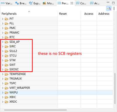

these is no SCB registers in peripheral registers view in s32ds
2,681 Views
LewisThin

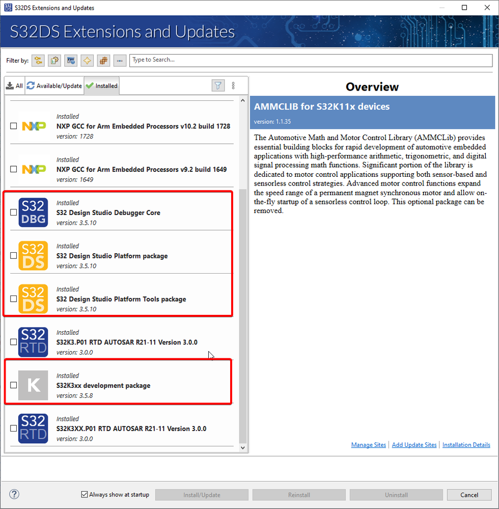

I updated RTD plugins and SDK of S32K3xx recently and then I found that the SCB group was missing.
further more, I can not downgrade the sdk and plugins in the case of which there is no the old ones in the "S32DS extensions and Updates page".

sorry for delay. I tested it with S32DS v3.5 and S32K3XX RTD v3.0.0 and there is no issue:
Please make sure, that you have updated all packages to latest version:

LewisThin
maybe sth is wrong, i changed the workspace and the issue was solved

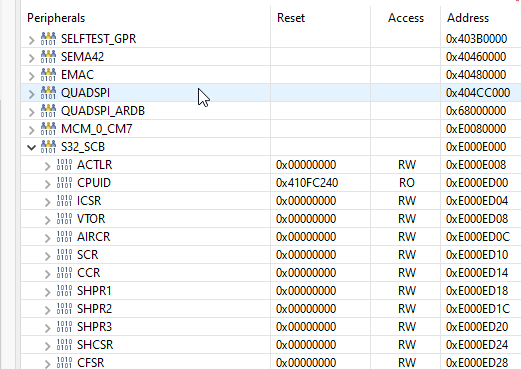

YulongHe
I meet the same issue and found these tickets. I found the root cause that maybe you missed the SVD configuration in the S32DS debugger setting, and this works for me. See below:

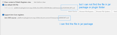

LewisThin
Tnanks for your reply. It works on my device. But I have a new question about the svd file.  see below. Could you pls give me more information .

YulongHe
Hi, I can find this file in this path. FYI.
