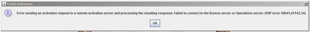

I recently downloaded the newly released IDES32 Design Studio for ARM v1.1 - Windows  from website: S32 Design Studio IDE|NXP;
I'd like to try the new IDE for S32K and KEA SW development.

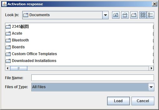

But I got the license activation request, and whether I choose online(of course, my internet is OK) or offline with the Activation ID the system sent to me by e-mail when I download it, I will got the following error with online activate:
and offline activate generate a request file(named request.xml) as attached and request respone as below window:
and then the installation will be rolled back and failed.

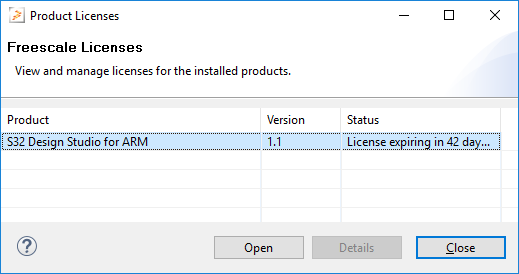

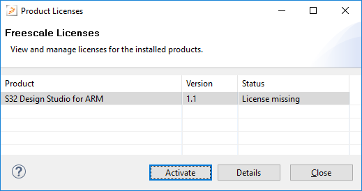

Hi Tomas,
Sorry about the delay replying, I got pulled into another project and only back to this today.

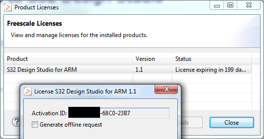

I currently have your temp activation ID working, however my activation ID still does not work.
When I open S32 and go to help/Freescale Licenses i see the following (this is the temp license):
However, when I return the temp license and enter my own it waits for a send, then closes the license dialog and shows this:
This happens whether I use online or offline activation methods.
I am continuing to use the temp license you provided, but I would be very appreciative if you are able to help me work through this issue.

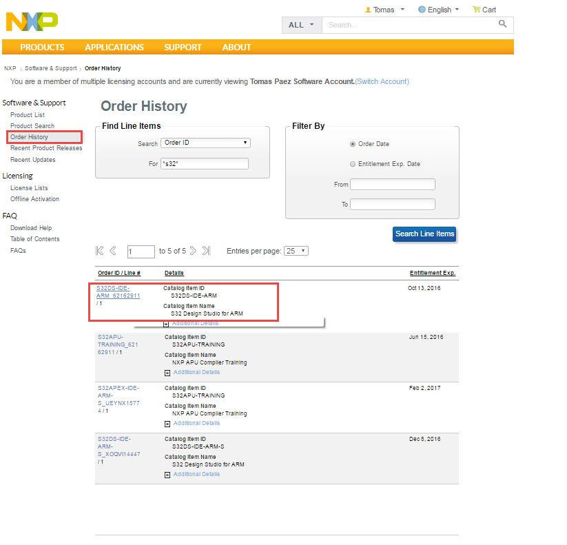

Please send me your entitlement IDs
Go to order history and look for the entitlement ID, must be named S32DS-IDE-ARM_XXXXX
I would like to see your request.xml and reponse.xml files
One question , do you have previous 1.1 version installed on this machine?
run a test using this temp activation ID as test, thank you.

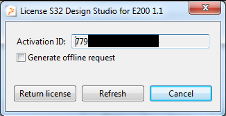

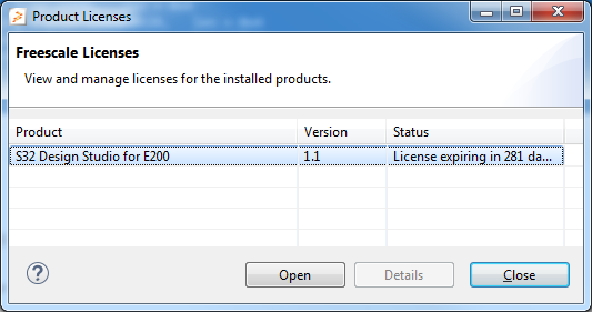

stanish
Hello Fergus,
Yes you can activate or return actiation directly in S32DS IDE:
go to Menu Help -> Freescale Licenses:
Click open:
Return license.
you can activate it back easily by pasting the activation code into "Activation ID" entry and click on "Activate"
Stan

enwei
Hi Martin,
In fact, I have tried several times in differernt time and on deferent computers(at least another 2 PCs), as my install log listed:
I always got the same error as above mentioned, FNP error 50041: Failed to connect to the license server or operations sever.
the install log shows more info:

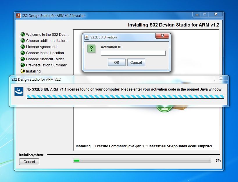

stanish
Hello Enwei,
Thanks for your question.
This is a known issue and it will be fixed in the next release.
It's caused by the fact that Windows users may have spaces and special characters in their names, e.g. “Johnny Depp” or “Phocée” that affect things.
Workaround:
1) Create an empty folder, e.g. “c:\temp”
2) Type “rundll32 sysdm.cpl,EditEnvironmentVariables” and set TMP variable from its default “%USERPROFILE%\AppData\Local\Temp” to that folder name “c:\temp”
3) Ensure that your changes accepted – now “set TMP” should return “TMP=c:\temp”
4) Install S32DS
Hope it helps!
Stan.

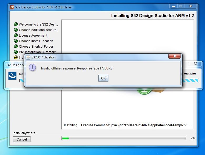

I have a similar issue as Fergus. I failed installing S32DS for ARM v1.2 today. The install tool asked for activation code of v1.1 and I entered code under my account (the code is for v1.2 ?). It rolled back and failed. Does anything I should do? Thank you very much.
BR, Jianlong Zhang

Thank you for your checking. I tried just now, but maybe because of sever's timeout (for both online and offline), I failed with below reasons. I will try to install later, hope it will work. Thank you.
BR, Jianlong

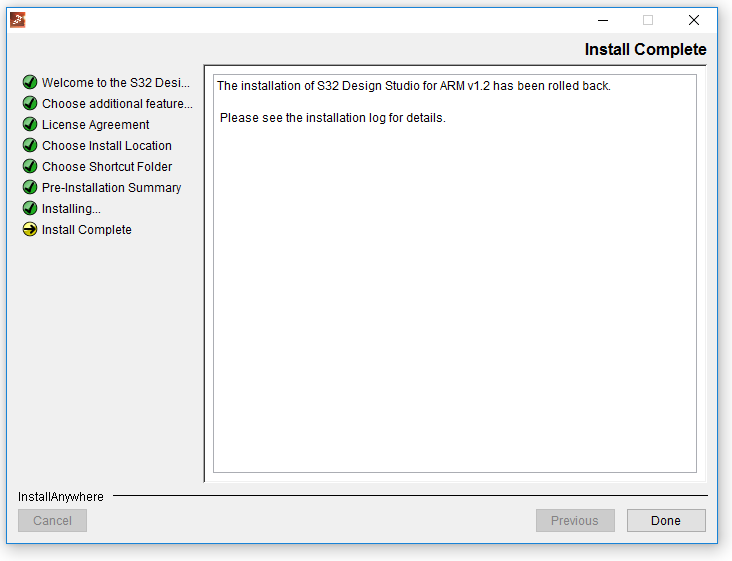

Hi Stan,
I'm experiencing a similar issue to what described above while installing "S32 Design Studio for ARM v1.2 - Windows.exe" on windows 10. The Activation code works correctly and says that the code is accepted, however it then proceeds to immediately roll back the install. The error in Enwei Hu's logs look identical to the errors in mine.
I tried your solution by changing the temp directory environment variable and it still failed with the same error.
Is there anything else I can try?
