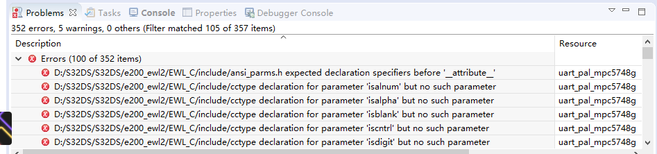

I try to debug the example project with the name of usrt_pal_mpc5748g. When I try to add some C head file such like #include <memory.h> and C++ head files such like #include <iostream> into the project, S32 always says "no such file or directory". So I would like to know how can I use those C/C++ head files in the S32 project to do some changes in the example project? Or the S32 does not support those head files. Thanks.

memory.h is not part of standard C. What you like to do with it?
iostream or iostream.h is located (with default install) in c:\NXP\S32DS_Power_v2017.R1\S32DS\e200_ewl2\EWL_C++\include\ folder. You need to add this folder into include paths.

Actually, I find an AES program which is written by C++, and I want to add it in to S32 project. As you said before, I add the path into include, and there is no problems with head files. But the program has those errors as follows.I wonder if there still are some points I should pay more attention to ?
