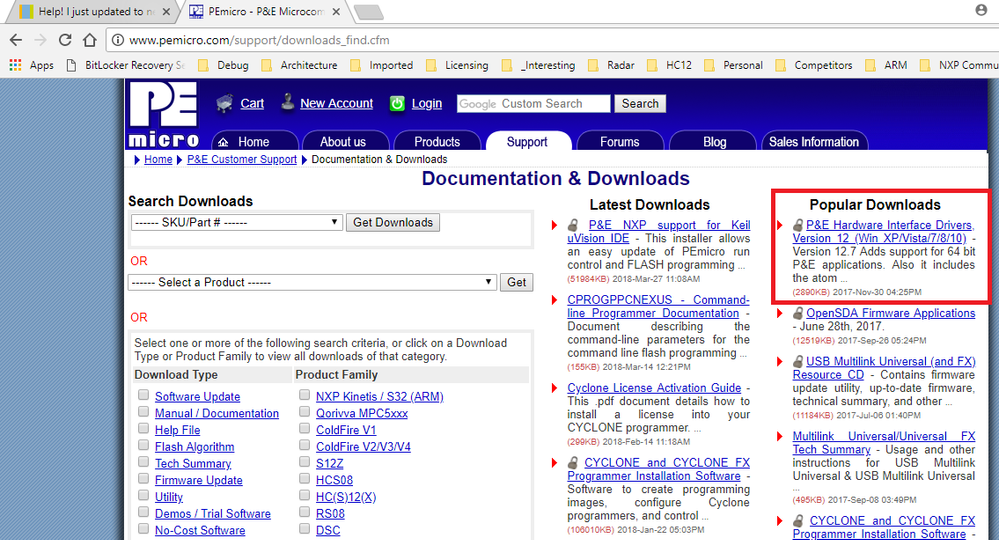

If you are using Windows 10 it is highly recommended to download and install the latest drivers by P&E:
If it doesn't help please let us know the version of your S32K144 chip populated on the board.
