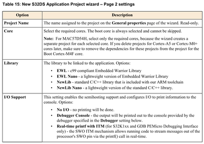

wei_w_he
Dear Lucas,
Thanks for the information. I notice we need to configure the Libraries support setting to ewl_c no I/O (-specs=ewl_c9x_noio.specs), and there are few options we can select such as newlib_nano no I/O, etc.
Is there doc. to explain the usage for each setting?
Thanks and best regards
He Wei
3,106 Views
lukaszadrapa
Hello He,
I'm not aware of such document.
EWL comes from Freescale/NXP, NewLib is a standard distributed under freeware license:
https://sourceware.org/newlib/
Some introduction can be found S32DS user guide (c:\NXP\S32DS_ARM_v2.2\S32DS\help\pdf\S32DS_ARM_User_Guide.pdf):
Documentation for EWL can be found here:
c:\NXP\S32DS_ARM_v2.2\S32DS\help\resources\manuals\ewl_c_reference.pdf
Lukas
