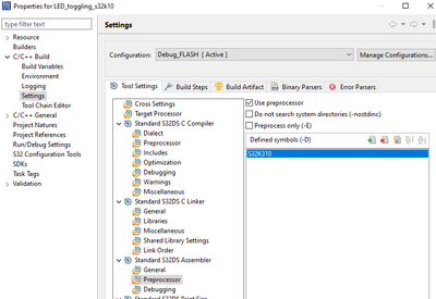

I tried your project and it has some SRAM init issue or similar. It goes away after I added S32K310 into asm preprocessor setting.
Then the project seems to run well as standalone. I uncommented Power_Ip_GetResetReason as well. It is going to standby and wakes up upon timeout or switch pressing. Terminal is showing "the value is 0 0 " still, after wake up too.

Thank you PetrS,
So I see the " S32K310" is used in the startup code. It is working as expected.
