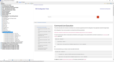

Hi @JasonChou
There is a section titled ‘Command Line Execution’. It includes instructions and examples on how to perform many of the commands available within the S32 Configuration Tools, including Pins, Clocks, Peripherals, DCD, and IVT, as well as general commands for the project configurations, import, export, code generation/update, builds and etc.
B.R.
VaneB
