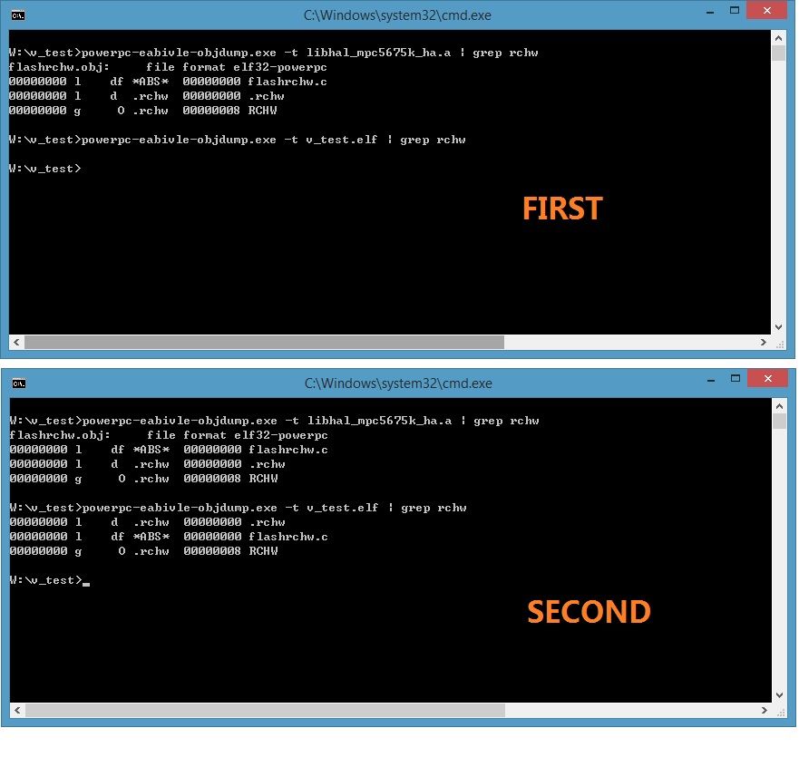

I am work for the mpc5675k bsp.
When I create the simple project from the s32ds, it work good.
But when i make my bsp pkg, contian the base files same as the simple project, to be a library.
And make a test app, contain the v_test.cpp.
when I link the main.o and the bsp library, the compiler make thev_test.elf.
but when debug, it can't work, cpu can't init.
I debug it ,and trace in to the flash memory, the vector of addrees 0, is emit by the compiler.
I must to add this code to avoid the bug:
#ifdef __GNUC__
extern const uint32_t RCHW[];
cuint32_t * p = RCHW;
vuint32_t k = *p;
#endif

You can use EXTERN directive in linker script to force this symbol to be resolved
/* Entry Point */
ENTRY(_start)
EXTERN(RCHW)

Thank you for this report.
This indeed seems to be an issue with GCC e200 binutils .
Our compiler team is now investigating this problem.
The only work around currently available is to create a dummy reference to the object in the code (as you did).
Stan
