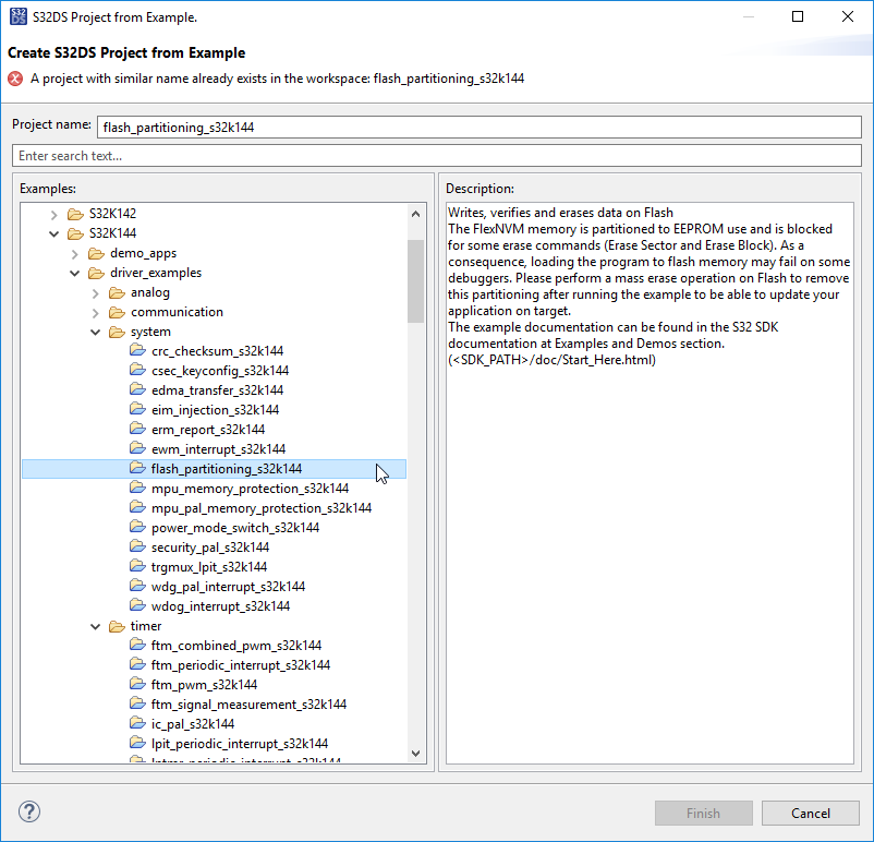

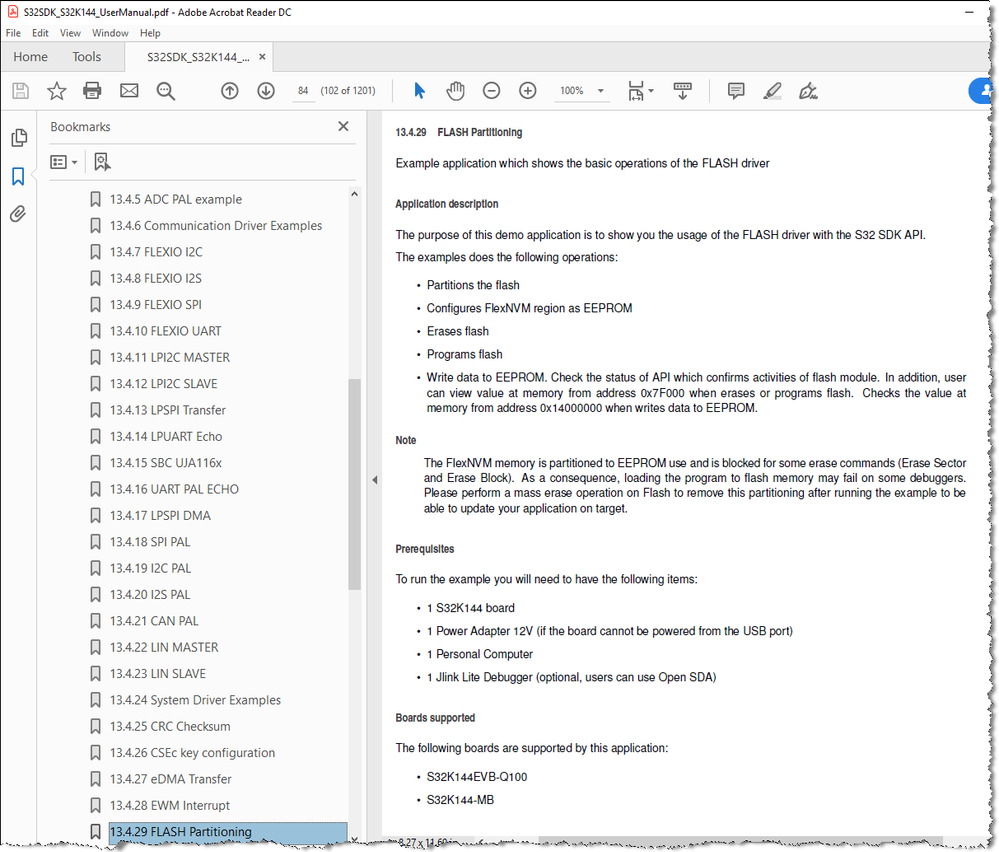

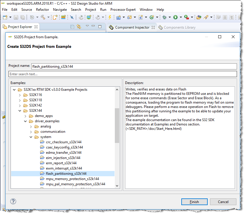

Robin_Shen
Hi Veeraju V Hallikeri,
Please refer the flash_partitioning_s32k144 example.
You can read the "13.4.29 FLASH Partitioning" of S32SDK_S32K144_UserManual.(C:\nxp\S32DS_ARM_v2018.R1\S32DS\S32SDK_S32K1xx_RTM_3.0.0\doc)
Robin

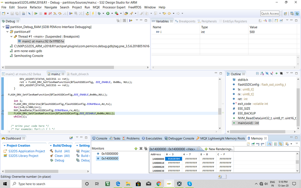

veerajuvh619
Hi sir,
I checked with the example code the data is storing in flex-RAM and its not storing in E-flash(backup eeprom),how to store data in backup eeprom?

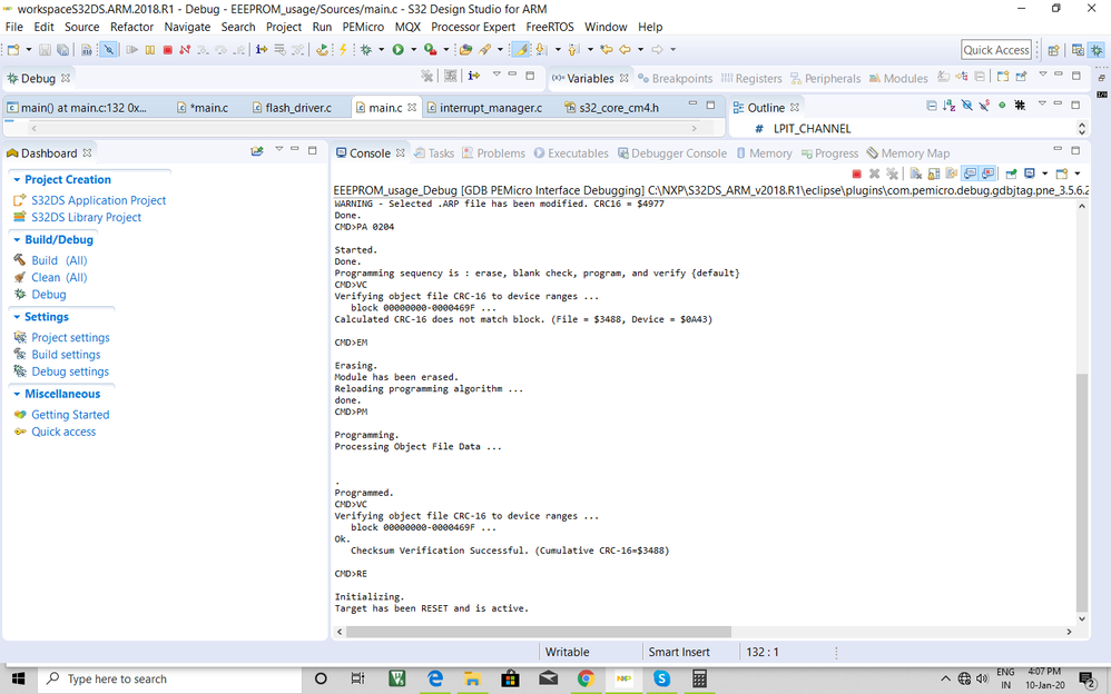

veerajuvh619
Hi sir,
I checked with "EEPROM usage code" i debugged with same code i am not getting data in E-flash memory,
I followed the steps in the following way
-i build the code in debugger format
-then i selected debugger
-in that i selected advanced options
-i configured same as you sent in picture and click on ok
-then debug
afterwords its showing like this
instead of 0204 can i give 020A for (flux-ram 2kb and E-flash 64kb)?
if i debug with another program the '0' values which are showing in the picture are also not getting ?
Please help me for finding solution.

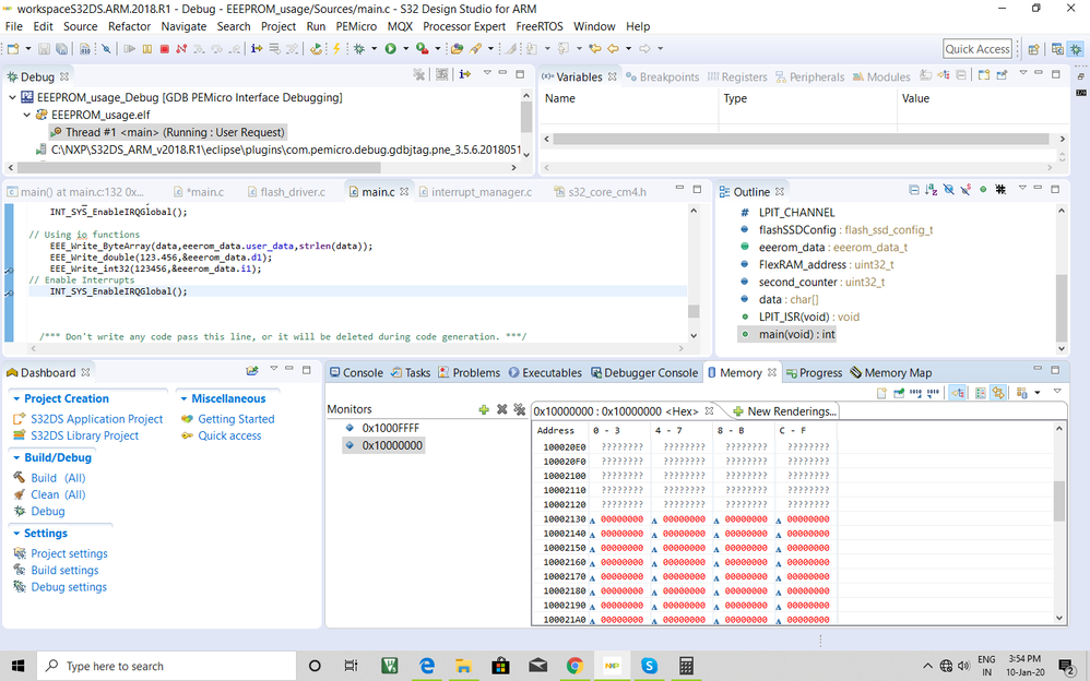

jiri_kral
FlexNVM is not accessible when used as backup flash for Emulated EEPROM. The only way how data can be accessed is via FlexRAM (0x14000000).
Unfortunately - PE Micro is not able preserve FlexNVM - and when .elf file is changed - backup flash is cleared while target flashing. You can test if it works as expected by board reset and attaching to running target. Second option is using "Send HW Reset to target"

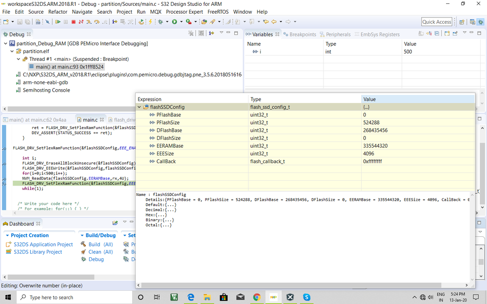

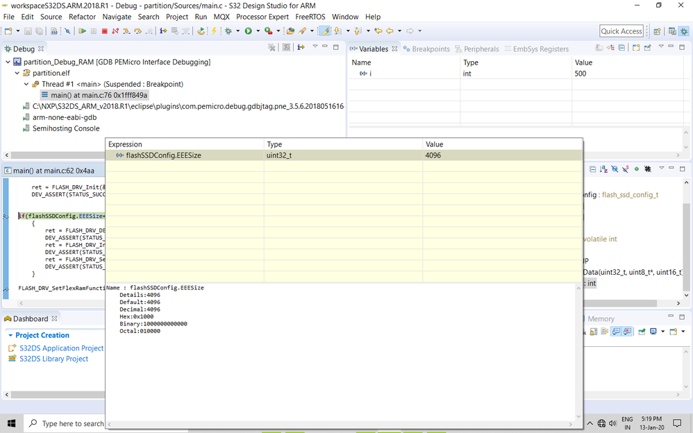

veerajuvh619
Hi sir,
In that EEE size is showing 4096 (that means partition has been successfully done) the data will store in this successfully, but the data is not showing in backup eeprom is there any criteria to store data in backup eeprom ?
Screenshot (33).pngScreenshot (32).pngScreenshot (31).pngScreenshot (30).png

jiri_kral
as I said above - when FlexNVM is configured as emulated EEPROM backup - it is not possible read data from that area even with debug probe. The only way how to check your data is by checking your mapped variables to FlexRAM or FlexRAM address in Memory view.
Jiri

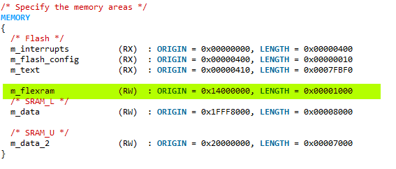

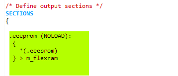

jiri_kral
in my opinion best way how to access your data is create structure and put it into FlexRAM section - for example like this:
typedef struct
   int timestamp;
   char fault_details[256]
} fault_details_t;
typedef struct
   int timestamp;
   char runtime_data[256]
} runtime_data_t
put both structures into eeeprom area:
fault_details_t fault_details __attribute__ ((section(".eeeprom")));
runtime_data_t runtime_data __attribute__ ((section(".eeeprom")));
In this case you don't need any address - you can normally read/write data like with normal structure.
Don't forget define eeeprom section in linker file:
After reset you find stored data in both structures. If you write new data into structure - data will be automatically stored in backup flash. After another reset - you will find new data in both structures.
Jiri

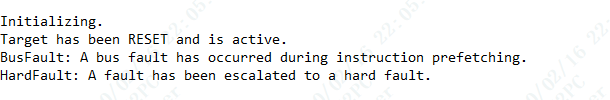

veerajuvh619
Hi sir,
I tried with this code by changing linker file but flow is going default ISR and I have one more quarry, I used condition but this condition will become true and then EEPROM READY resistor bit will set I am confused weather the partition is done successfully are not.

jiri_kral
Do you know which line causes exception? You need to wait for EEEPROM readines between writes into FlexRAM:
eeerom_data.p1=100.0;
while ((FTFC-> FSTAT & FTFC_FSTAT_CCIF_MASK) == 0){}
eeerom_data.p2=200.0;
Jiri
