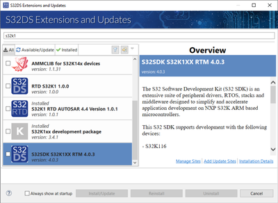

Hello mikedoidge ,
Facing Same issue with S32k144 .I have installed S32_SDK_S32K1xx_RTM_4.0.3
I need to know how this processor we have to link with IDE

5,897 次查看
AbhishekK
Hello mikedoidge ,
I am using s32 DS 3.4. Please Provide me s32k1XX SDK Zip file or link .it will be helpful. So I can add this file in Extention and update.
as s32k1xx Development Package is not available with me.

5,885 次查看
mikedoidge
Hello @AbhishekK,
If your machine is connected to the web, then the package should already appear in you S32DS Extensions and Updates menu. The package is provided on the update site.
However, if you do not have access to the web, you already have the offline version of this file available for download within your account. Please proceed to the same page where you downloaded the S32DS 3.4 install. There is another file 'S32 Design Studio 3.4 S32K1xx Service Pack 1 for offline use'. Download this file and add it to S32DS Extensions and Updates as a new update site. Then you should see the SDK listed.

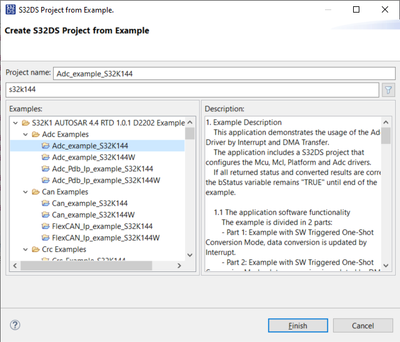

5,659 次查看
AbhishekK
Hi Mike ,
Can you Please share me the link of this Project S32K14X_MCAL4_2_RTM_1_0_0_Sample_Application
5,628 次查看
mikedoidge
Hello @AbhishekK,
Please proceed to the RTD product page to locate the link to the latest version of the RTD for S32K1xx. As of today, the current link is: https://www.nxp.com/webapp/swlicensing/sso/downloadSoftware.sp?catid=SW32K1-RTD44-D
