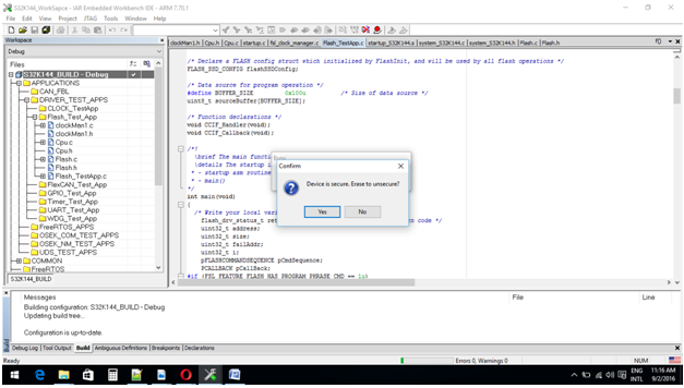

hi,
Everytime we try to program, debug or erase our Freescale S32 using the Multilink JTAG interface we get this error IAR
"Device is secure. Erase to unsecure?"
The board has been working fine before.
i have tried to erase block memory and flash some array and read the same data.
since that we haven't been able to program, debug or erase.
how to recover the device Any other solution ?

    I have been tried in IAR work bench using PEmicro debugger, IAR has memory erase option in Project-> download ->Erase memory->erase All.
although same "Device is secure. Erase to unsecure?" window is appeared.
after that I could not able connect the target board.
kalidass

Hi Rebecca,
   Thanks for your response, i have been tried by selecting  "yes" option on the error message but after selecting "yes" the connect manager window has appears and stop communication with target board.
   I don't have another debugger currently, so far i have been tried with PEmicro debugger only. now i'm sending my target board to NXP support.

Hi Kalidass,
Can you possibly post the error message screenshot?
Which Board are you using? FRDM-S32K144 or any other ARM based board?
