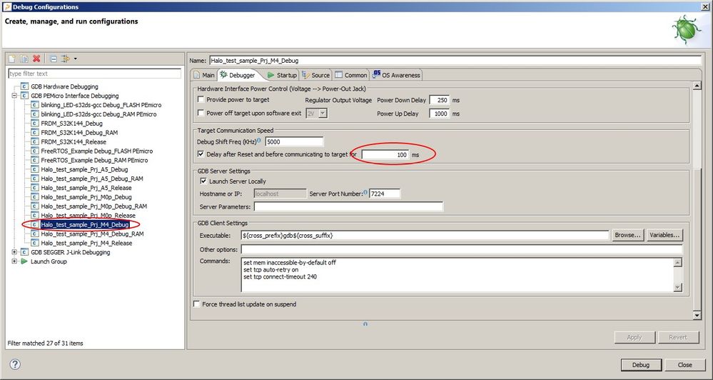

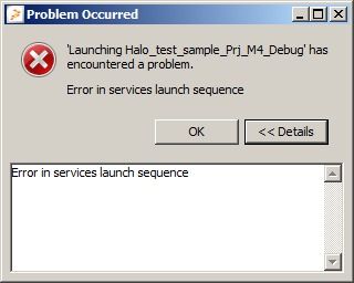

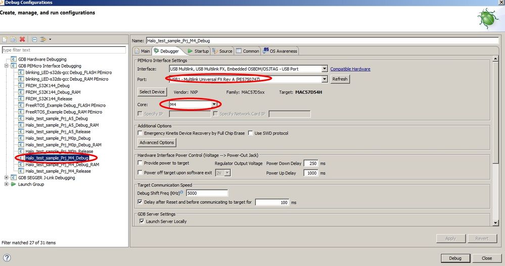

I am tring to debug MAC57D54(Halo) with S32DS for ARM v1.2, I created a simple project with its New S32DS Project wizard, it's compiled successfully with no any errors/warnings. but with I debug the M4 core ith Pemicro U-Multilink Rev.C/Rev.A[(FX), it failed with "Error in services launch sequence":
the default debug configurations does not work, so I modified some settings as below, while the problem continues:
Have anyone met such problem, and could give some suggestions?

Hello Enwei,
I have a little different board (SCH-28792 RevC - smaller and processor is on a separate daughter card) and the connection works fine.
Anyway I've heard from my colleague who used the board you have that there might be a problem when internal flash is empty - it causes an instant reset to occurs and it could be difficult to connect to the board.
There is TRACE32 script available if you have a Lauterbach debugger available which should help to connect (attached).
Can you try to add a longer delay after reset ? e.g. 10s=10000ms?
Do you have a P&E Universal (non FX variant) available?
Does your P&E FX probe works with any other Arm board? There might be perhaps an obsolete firmware ...
Stan

Error in services launch sequence The GDB Server was not able to establish a connection to the target processor. Please check your connections and power.

enwei
HI Stan,
I tried to set the reset delay time to 10s as you suggested, and debug with U-Multilink, it can work now, thank you~!
After further test, I found the single-M4 core debug works well, but when lauch group and enter multi-core debug, I cannot control A5 and M0+ core any more, they are always runing, and if I try to suspend A5 or M0+(the M4 core is OK as single-core debug), it will teminate the GDB debug server and the debug disconnected.

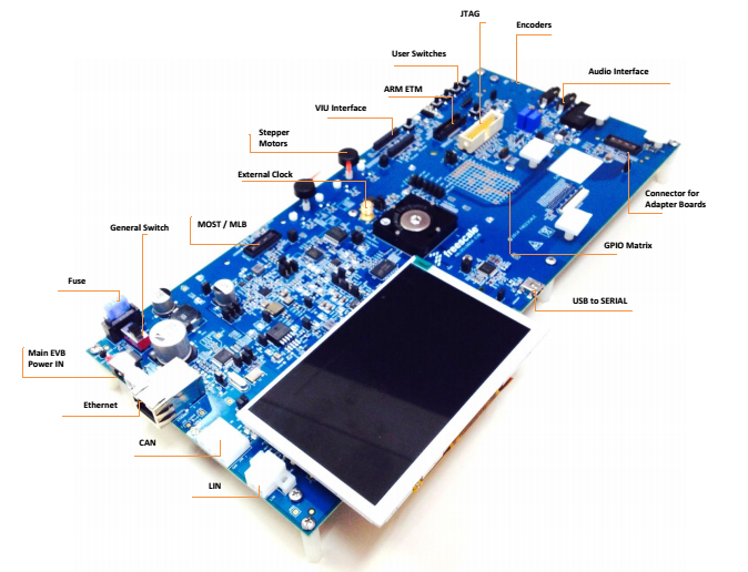

enwei
Hi Stan,
I am using the blue EVB with 516BGA package(X-HALO516BGA-EVB), its schematic number is: SCH-28363 PDF: SPF-28363, it's the Rev. B:
how many versions does the EVB have, and what's their difference?
