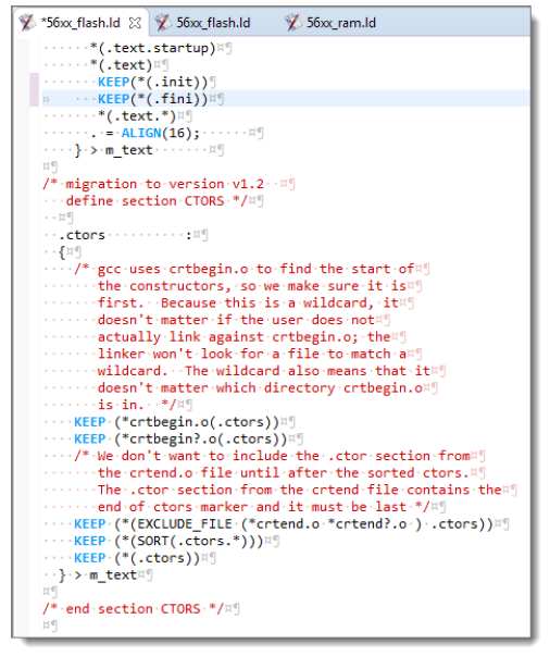

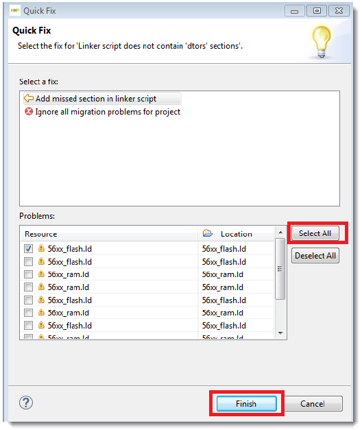

FYI:
If you use IDE project in S32DS v1.2 - there is an automatic way to fix the linker differences.
You basically right click on a linker script warning in Problems View and select  "Quick Fix" option.
This will add the additional linker sections that are required by the updated GCC compiler/linker:
This feature is documented in FAQ manual:
<S32DS_Power_v1.2>\S32DS\help\pdf\s32ds.pwr.win.faq.pdf
section "3.3 Open a project made in previous version of S32DS Power"
Stanislav
