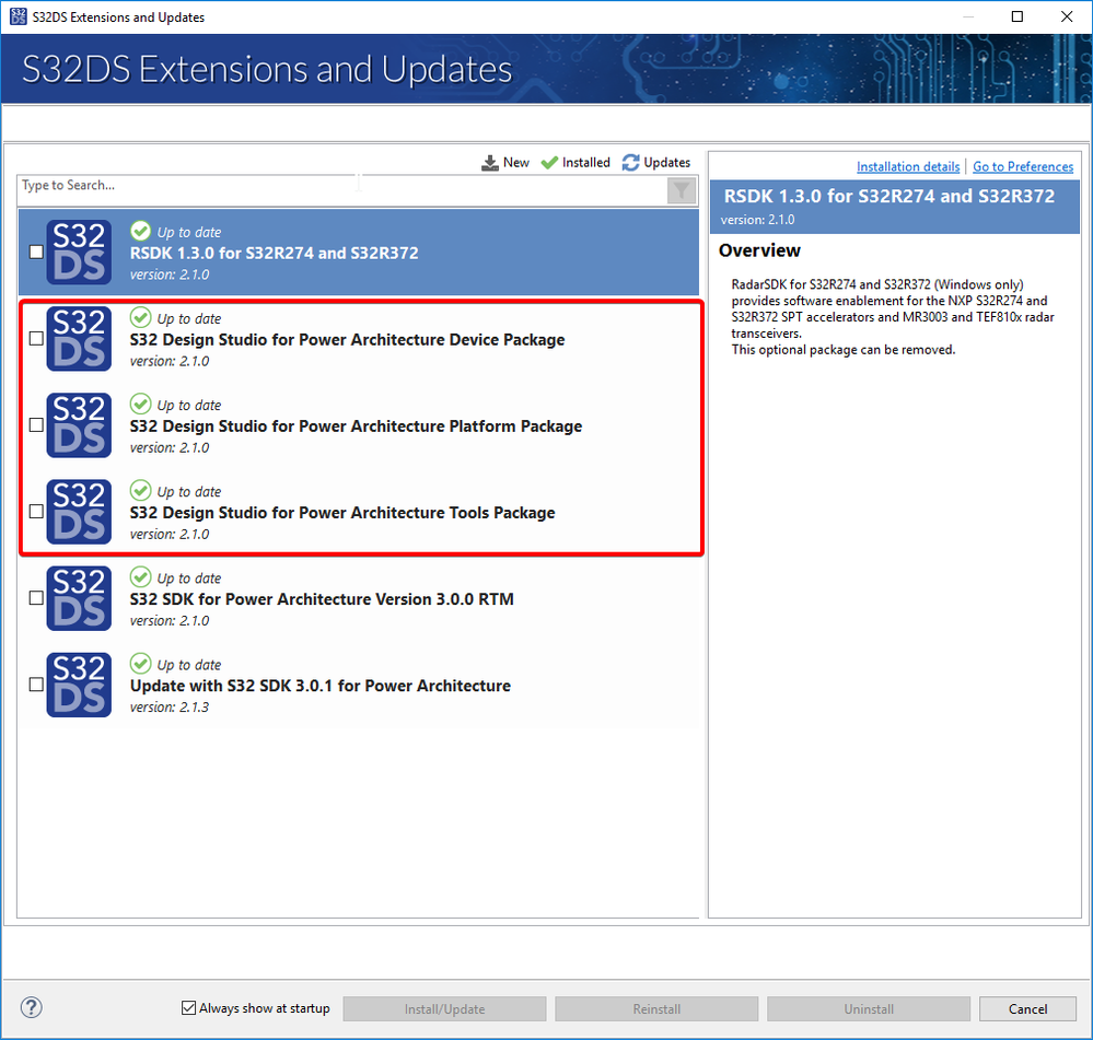

jiri_kral
do you have installed these packages in your S32DS? (Main menu bar -> Help -> S32DS Extensions and Updates:

wanbenzhou
Hello!
I have installed the above package.
My new project can be compiled.
But when I open the example project downloaded from the official website, it is not compiled, there will be the above error.
Who knows, give pointers.
