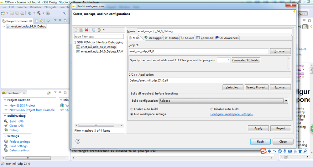

I use MPC5748G-LCEVB,s32 version is S32DS_Power_v1.2,i want download code to flash,but the  software not working.i can debug it step by step,it can working normally.
I flash step as follow
flash message in console as follow.

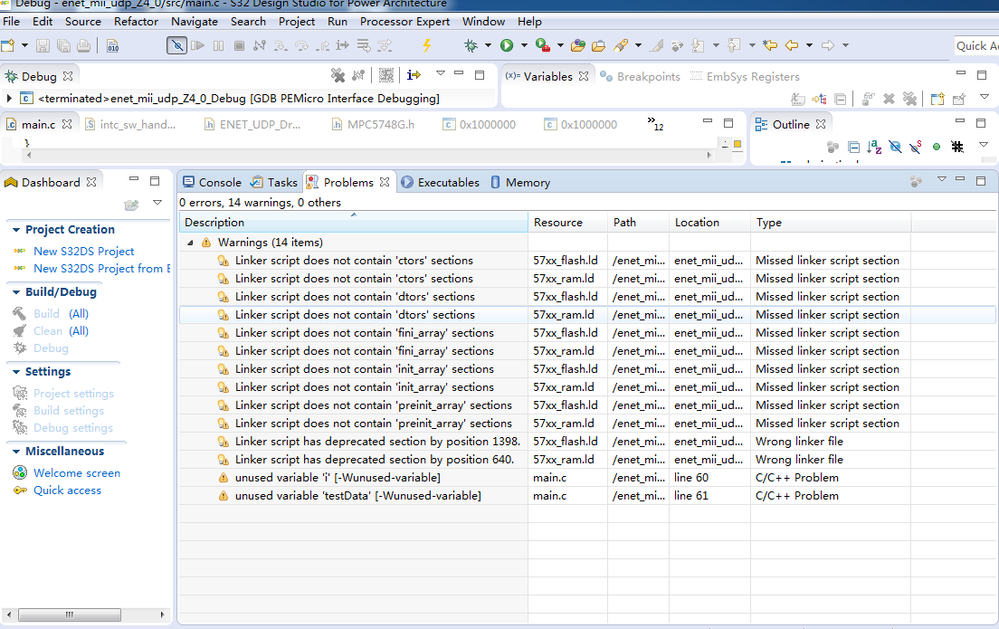

It the problem of the linker .ld file, you should pay attention on it. I meet the same problem before.
2,603 Views
威杨
Thanks for your answer.i find some problem when flashing.
but i don't know how to modify,could you tell me how to slove it ?
2,603 Views
jiri_kral
please look at this tutorial - https://community.nxp.com/docs/DOC-335361
you need to add into your linker file missing sections.
Jiri
2,603 Views
威杨
Thanks for your help,i follow to your advice, 14 warning is missing.but flashing still not work.
I want to know the normal message what is it,please help me.
Thank you very much.

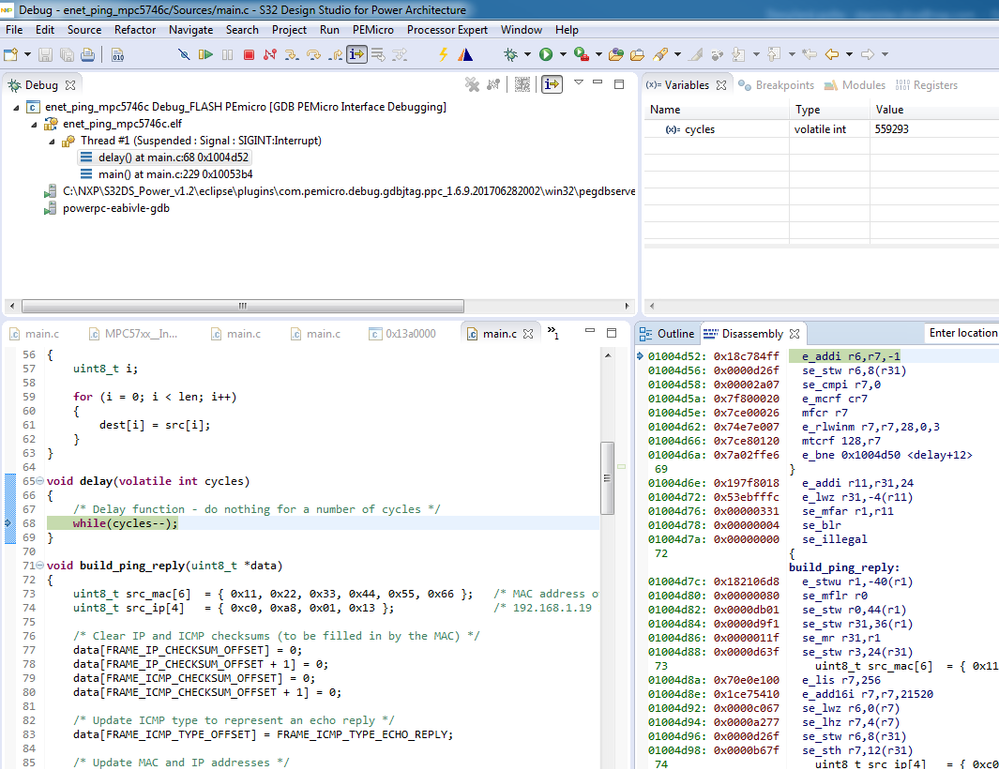

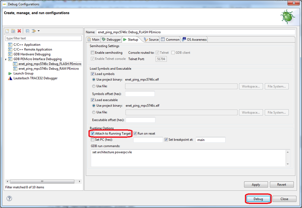

Could you perhaps try to attach to the running device (after power off/on sequence) and pause the running device?
Can you post the debugger screenshot to see at which address the execution has stopped?
This may help us to figure out what is going on.
Thanks!
