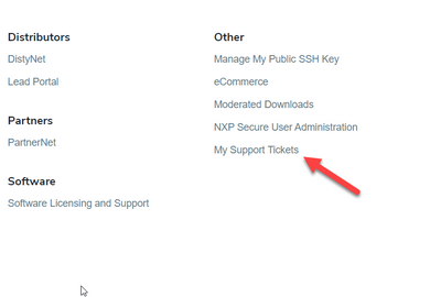

For opening a ticket, you should be able to follow the steps shown below:
Click the "My NXP Account" under the NXP main page (link: Automotive, IoT & Industrial Solutions | NXP Semiconductors
Then select the "Other > My Support Tickets" option and you should be redirected to the site for creating tickets:
Please, let us know.
