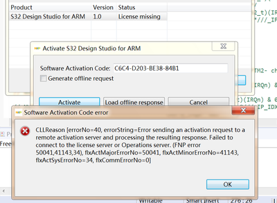

Hi:
My license of S32DS for ARM 2018R1 IDE has expired. Could you help check and extend it for me?
S32-DS-VISION_V2018.R1_187191607
Activation code: C6C4-D203-BE38-84B1
Thanks.

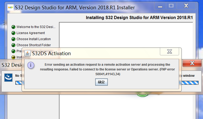

GAODU
Uninstall and reinstall the S32DS software.An error message is generated when the following activation code is used.Please check it again.
S32 Design Studio for ARM v2018
Total Number of Licenses:100
Activation CodeFD88-476A-D03B-A42C

mikedoidge
It's likely that you are having some issue with a firewall blocking access to the server. Perhaps try again but use the offline activation method. If this method fails, you may need to use another internet-connected device which can access web pages and is connected to a public wifi where there is no firewall and then use the offline activation method.

mikedoidge
The entitlement for this activation code is set to expire in the year 2027. In fact, it was only just issued on 05 September 2022. What error message are you receiving?
