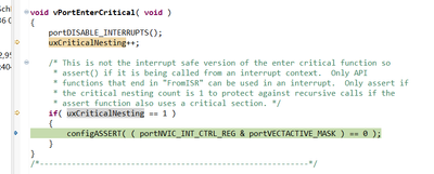

I'm currently using the S32K396 MCU with a raw TCP client implementation, which works fine. However, my module supplier requires me to switch to lwIP with FreeRTOS.
After importing the 'lwip_FreeRTOS_s32k396' example project and flashing it to my K396 board, the program enters the vPortEnterCritical() function when executing prvPortStartFirstTask(). How can I resolve this issue

alejandro_e
Hello @zhangzhixing,
Please open a create post  in the S32K community. Since you already selected an accepted solution I won't receive proper notification on the updates in this post.
Please include the following in your new post:
S32DS version
RTD version
lwip version
FreeRTOS version
NXP board name or specify that you are using a custom board.
If you have done any modifications to the example.
For now, it would seems as if you are entering the vPortEnterCritical() function from an interrupt, and you should be using vPortEnterCritical_FromISR() instead. If you are not entering from an interrupt, please specify that in your new post.
