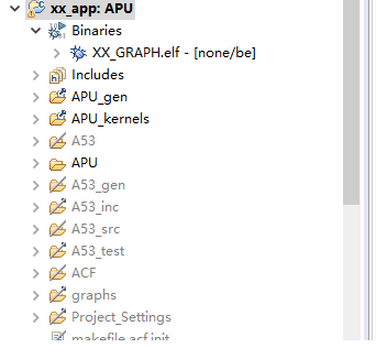

XX_GRAPH.elf,I has build in a S32DS APU project。
how to use,and run on the S32V234 device?

The ELF file built for APU is loaded to the APEX2 core by the code which executes on the A53 core. It is not much usable by itself and cannot be loaded independently.
Mike
