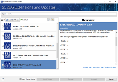

namnguyenviet
Please update S32K3 RTD AUTOSAR 4.4 RTD 2.0.0 via S32DS Extensions and Updates:
Nam
