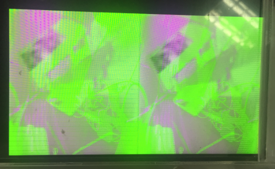

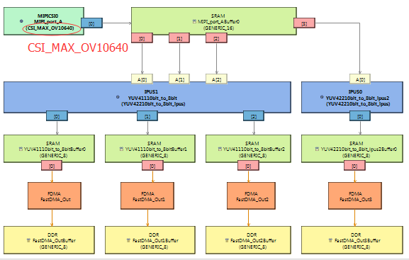

Yes, my cameras  are maxim ov10640 , and the graph is referfence to ov10635 demo, just like this:
and the image in lcd is:
our yuv422 data format is YUYV YUYV ........

the ov10635 camera has built-in Debayer, but from ov10640 you are getting raw data. You need to put in your ISP graph Debayer box. You can look at ov10640_12bcomb_surround example for inspiration.
Jiri
