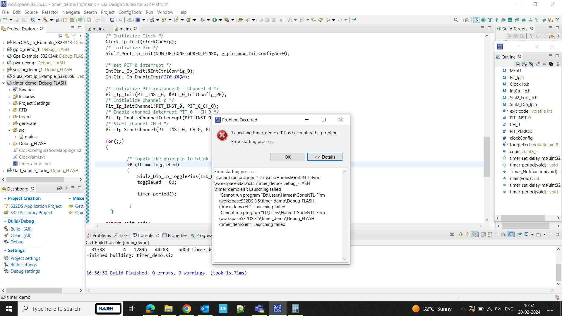

Our S32 design studio version is S32DS 3.5, and we are using the S32K344 EVK board.
The code is debugging correctly, however we are running into issues when we try to program the EVK board.
Kindly refer to the attached document.
Please assist me in fixing the problem.

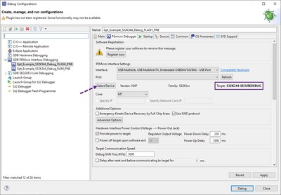

Please try just the ones created with the project, for example, Siul2_Port_Ip_Example_S32K344_Debug_FLASH_PNE.

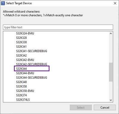

The debug configurations are correct, but I saw that you have selected as the target device the S32K344 SECUREDEBUG. This configuration is only used when a JTAG key access is set. If you do not have secured JTAG access, use as the target device the S32K344.

For us debugging is working properly. But we are unable to program(run mode - see in attached screenshot) the micro controller.

According to the images shared, I saw that you have a bunch of debug configurations for the same project. Please try just the ones created with the project, for example, Siul2_Port_Ip_Example_S32K344_Debug_FLASH_PNE.
