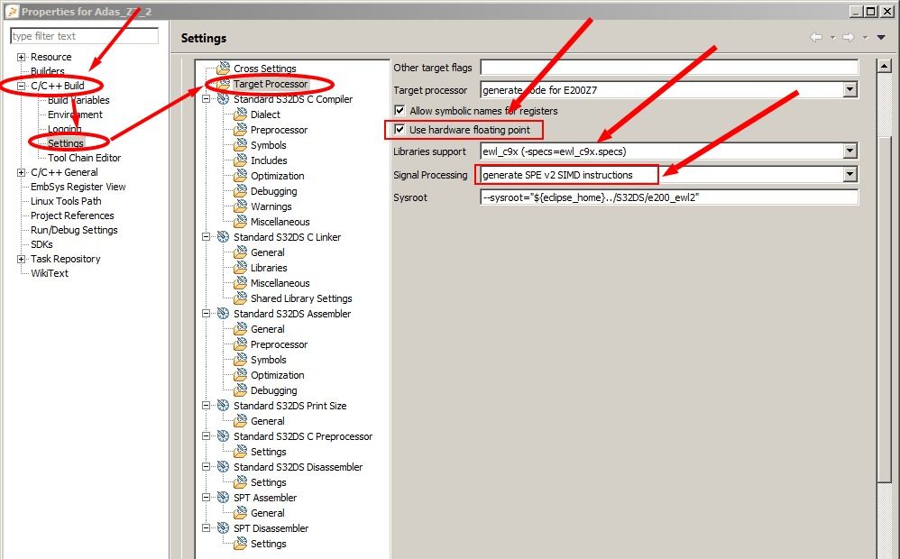

As we know, in most of our MPC57xx parts, such as MPC5775K as below, there are VFPU and SPE2-SIMD, which are very useful when doing DSP and complex math calculation.but how can we enable and use it in a S32DS project?
MPC5xxx 32-bit MCU for ADAS Applications
There is no options for this when create the project, and there are some related options in project properties-->C/C++ Bulid-->Stettings-->Target Processor, I checked Use hardware floating point, and configured Signal Processing: generate SPE v2 SIMD instructions and use ewl_c9x library:
However, after configurations as above, I find the disassemle code has nothing differerent,  no performance improve, no SPE instructions generated for my codes, it seems still call the ewl_c9x library to complete my math operations:

It's OK now, it seems can only work with newlib.
Besides, it's necessary to add the below codes in startup.s to enable SPE before use it:

This is a know compiler defect - ENGR00382137 - mspe2 options doesn't enable SPE codegen and doesn't switch to SPE libs
Could you possibly add the switch "-mspe" into both compiler and linker flags.
Stan

gcc C compiler cannot use these specific SPE2 vector instructions for C code.
The only way is to use these instructions in inline/standalone assembly, or use SPE intrinsics.
Simply include "<S32_Power_v1.x>\S32DS\e200_ewl2\EWL_C\include\pa\spe.h" to your .C module and use the intrinsic functions available in the header file.
