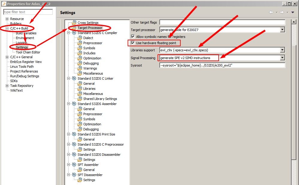

As we know, in most of our MPC57xx parts, such as MPC5775K as below, there are VFPU and SPE2-SIMD, which are very useful when doing DSP and complex math calculation.but how can we enable and use it in a S32DS project?
MPC5xxx 32-bit MCU for ADAS Applications
There is no options for this when create the project, and there are some related options in project properties-->C/C++ Bulid-->Stettings-->Target Processor, I checked Use hardware floating point, and configured Signal Processing: generate SPE v2 SIMD instructions and use ewl_c9x library:
However, after configurations as above, I find the disassemle code has nothing differerent,  no performance improve, no SPE instructions generated for my codes, it seems still call the ewl_c9x library to complete my math operations:

So, how can we enable and use the powerful VFPU and SPE2-SIMD in S32DS project?  Is there any addtional header files should be included or any SPE/FPU initialization needed besides the above project settings/configurations?

enwei
It's OK now, it seems can only work with newlib.
Besides, it's necessary to add the below codes in startup.s to enable SPE before use it:
I also attached my test project in S32DS version for your reference(the spe intrinsics instructions is tested in z7_1 CPU core project):
;#*************************** Enable SPE Bit in MSR ****************************
       mfmsr r6
       se_bseti r6,6
       mtmsr r6
Thanks very much for Stan's great support on this case~!:smileyhappy:

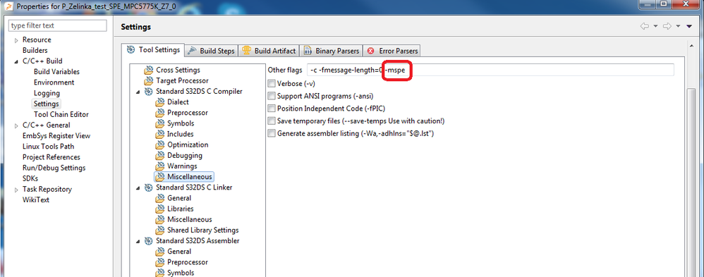

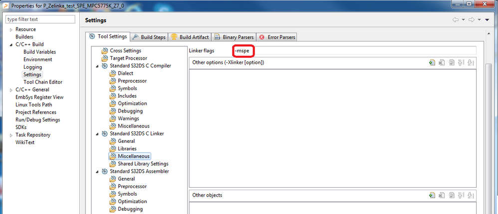

This is a know compiler defect - ENGR00382137 - mspe2 options doesn't enable SPE codegen and doesn't switch to SPE libs
Could you possibly add the switch "-mspe" into both compiler and linker flags.
Stan

enwei
Hi Stan,
I tried your suggestion and added the switch "-mspe" into both compiler and linker flags, it reported new error:
"Description Resource Path Location Type
C:/Freescale/S32_Power_v1.1/S32DS/e200_ewl2/EWL_C/include/pa/spe.h expected '=', ',', ';', 'asm' or '__attribute__' before 'static' MPC5775K_SPE_demo_prj_Z7_0 line 329, external location: C:\Freescale\S32_Power_v1.1\S32DS\e200_ewl2\EWL_C\include\pa\spe.h C/C++ Problem
what's wrong? how can I solve it?
