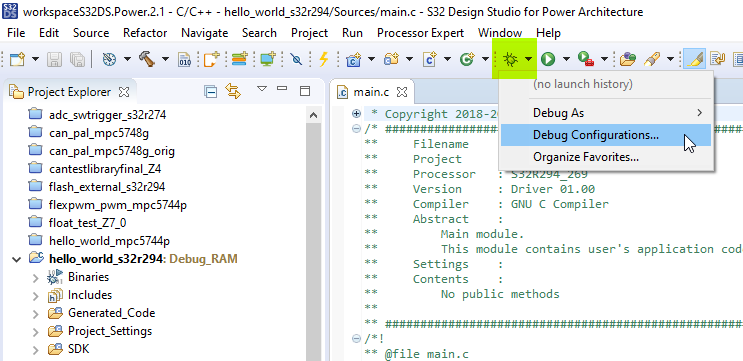

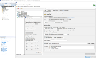

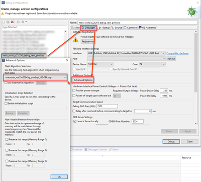

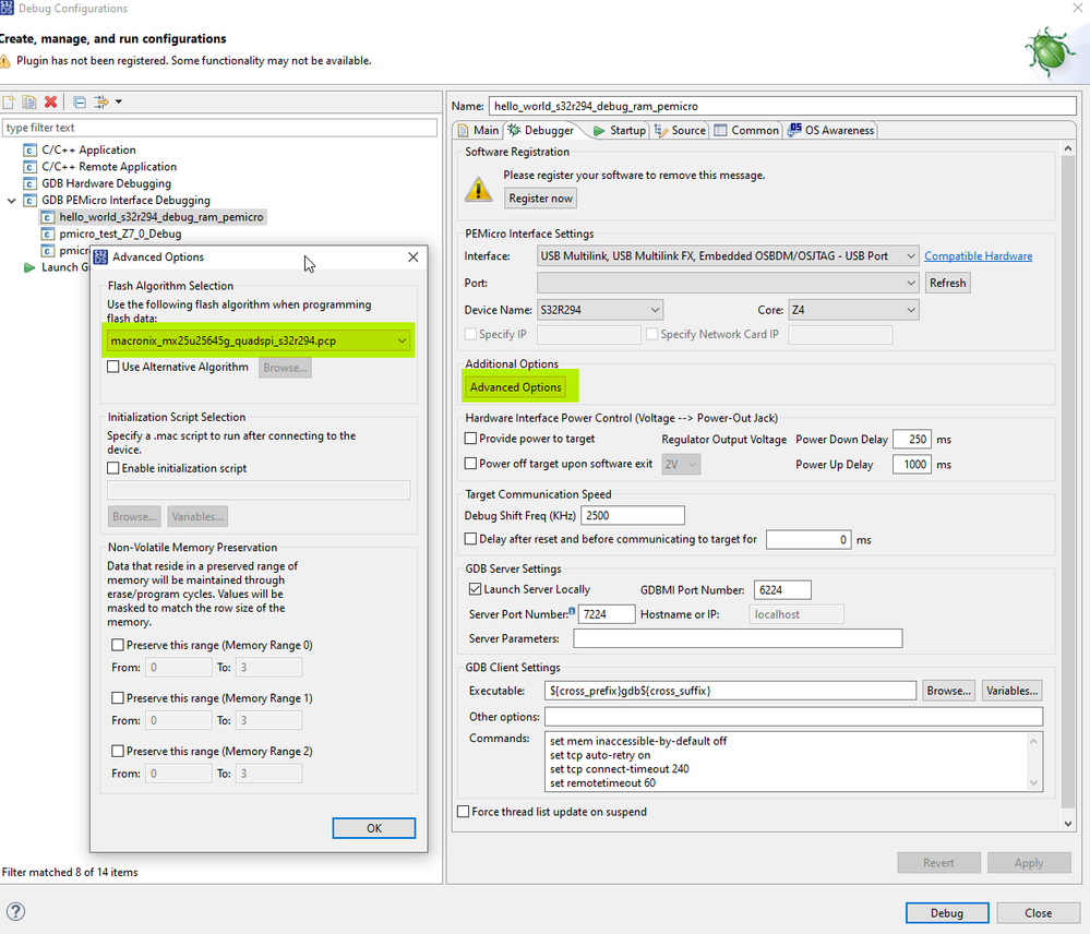

jiri_kral
I'm not sure what is your debug probe - let's assume that you have PE Micro Multilink FX. You can select Debug Configurations here:
Select your debug probe, check the programming algorithm and simply press the Debug button:
If you are new in S32DS - good starting point is Help folder - with default install path located in c:\NXP\S32DS_Power_v2.1\S32DS\help\

HyunungPark
Hi.
I think that a debug configuration sets normally like the below picture.
I select the debug and run button.
In the case of debug button, the application runs normally.
But in the case of the run button, the application doesn't run normally.
Could you please let me know what is problems?
and I have one question.
Does the firmware download into the external flash?
