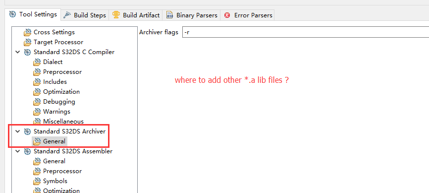

in S32DS  2017.R1, I create a S32DS library project, and am going to create a big lib file, which will put other sub lib files together.
for instance, create a libsdk.a library, this library will contain a.c, b.c, and lib1.a, lib2.a, lib3.a.
in the archiver settings, I didn't firgure out how to add the additional library files.

wesleyxie
Hi, Jiri
finally, I figured out the build script to create huge lib. I added it in build-step commands, and it works.
thanks for your help.
mkdir -pv sdk_own/lib && cd sdk_own/lib && rm -f *.o && for i in ${ProjDirPath}/sdk_own/lib/libfmc_*.a; do powerpc-eabivle-ar -xv $$i; done
powerpc-eabivle-ar -rcsv ${BuildArtifactFilePrefix}${BuildArtifactFileName} sdk_own/lib/*.o && cp -fv ${BuildArtifactFilePrefix}${BuildArtifactFileName} ${ProjDirPath}/../common/sdk/lib/

jiri_kral
you can make thin archive by:
ar -rcT libmyhugelib.a lib1.a lib2.a lib3.a
Second option (in my opinion more clean) is to extract all .o files from existing archive and re-archive extracted *.o files into one .a. Something like this:
ar -x lib1.a
ar -x lib2.a
ar -x lib3.a
ar -c libmyhugelib.a *.o
Jiri
