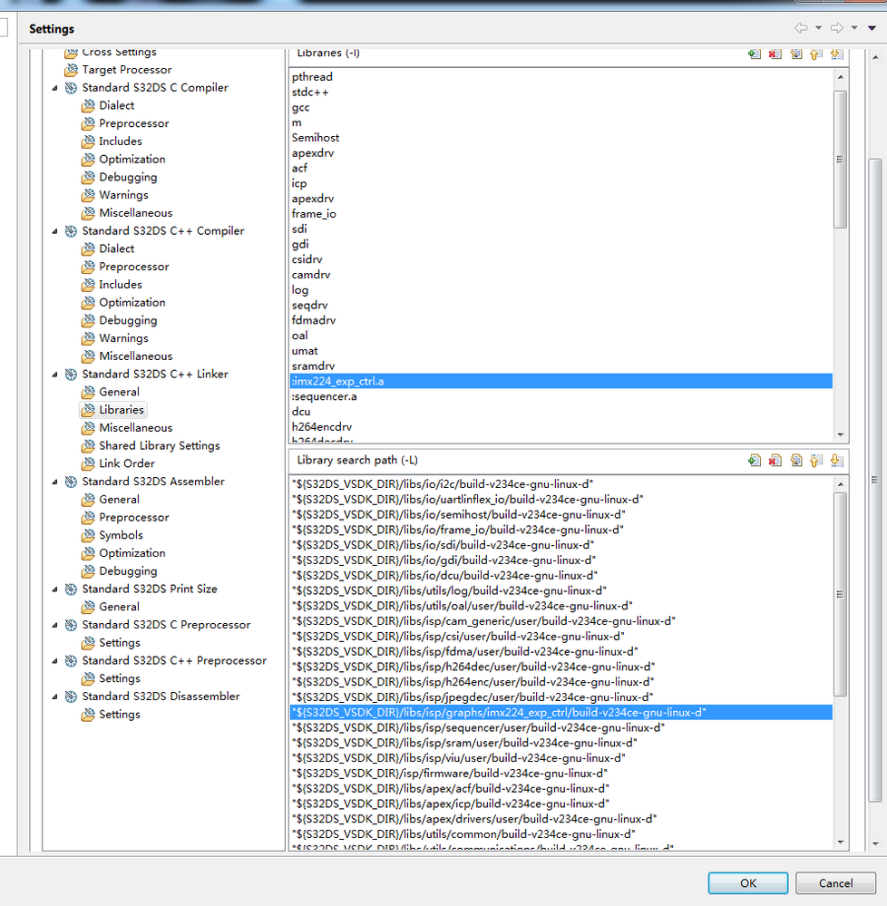

i found i can't add the "imx224_exp_ctrl.a" libaray to my s32ds application. is my way wrong?
1,773 Views
jiri_kral
the imx224_exp_ctrl.a is located in [VSDK_ROOT]/isp/graphs/...... not in [VSDK_ROOT]/libs/isp/graphs/......
Jiri

thanks!
