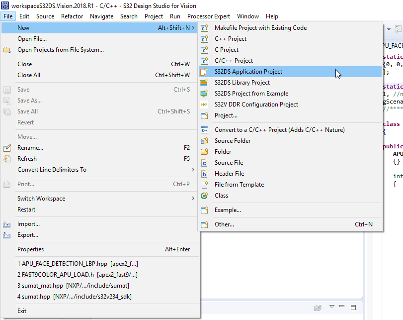

When i am using  S32DS for Vision IDE, I try to download .elf file or .s19 file to M4 core ,however ,there is no flash from file tool in S32DS for Vision IDE ,I  wonder if there is someway I could download this tool and add it to the S32DS for Vision IDE ,Hope someone could answer my  question , I'll be very thankful !

create new empty project
Select M4 core:
In debug configurations select your .elf (or srecord) file and start debug session:
Hope it helps.
