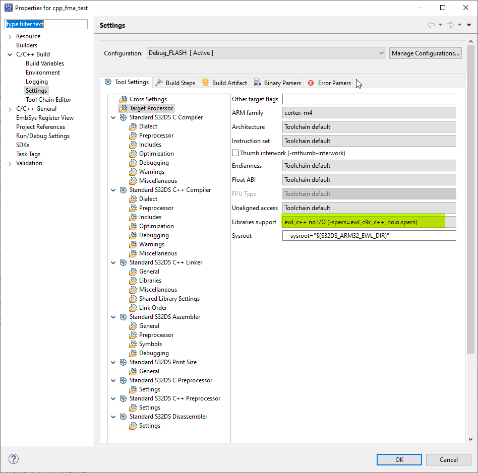

jiri_kral
it looks, that fma is not part of std for NewLib. With EWL library it is working okay:
Hope it helps.
Jiri

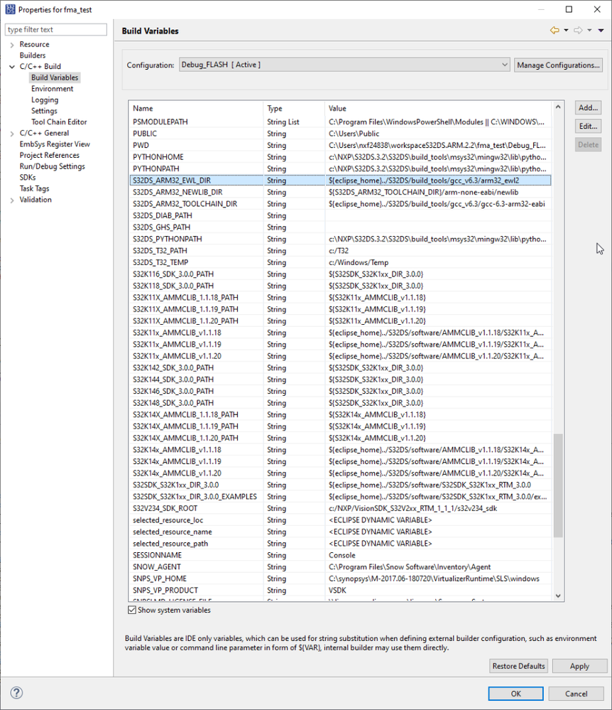

jiri_kral
Actually - I just switched NewLib to EWL  as shown on screenshot above. I didn't modify any path/variable:
Jiri

jiri_kral
.prefix files for ewl are located (with default install path) in
c:\NXP\S32DS_ARM_v2.2\S32DS\build_tools\gcc_v6.3\arm32_ewl2\EWL_C++\include\
folder.
You probably modified some build variables. Normally you can choose C/C++ library from menu and that's it. S32DS sets all variables automatically for chosen C/C++ library.
