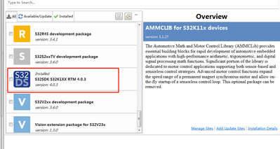

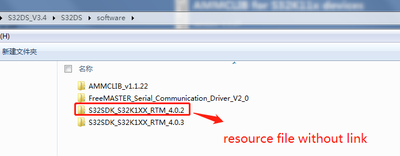

My project is based on RTM4.0.2 .
but after i reinstall S32DS v3.4 ,i can't complie my project correctly because the only version for S32K1XX in S32DS Extensions and Updates is RTM4.0.3
I try to find the RTM4.0.2 update zip on NXP official website, but it was difficult for me to find it..
I wish that you can give me a download link of RTM4.0.2 update zip or offer a method ,like relink the RTM4.0.2 resource file to S32DS(I have a backup in other computer)

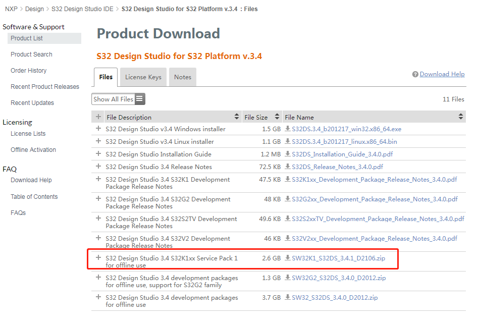

at last I find that S32K1XX RTM 4.0.2 was included by this package

Yes. You are right. This was mentioned in this post: S32 Design Studio v3.4 S32K1 Service Pack 1 released!
