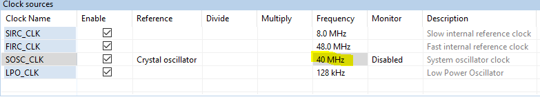

As you know, we are using the S32K144 and S32K166 in our scooter.
We got a S32K116EVB and trying to make the CAN port communicate with P-CAN device to our laptop.
We supply the S32K116EVB external 12V power supply, put the jumpers in the right position and try to run the can_pal_s32k116 example code from the S32SDK_S32K116_EAR_1.8.7 SDK.
We can't make it work. it doesn't receive messages and when trying to transmit (using the push button to invoke the transfer), the bus goes to heavy-bus error state and the error IRQ is triggered all the time.
We than configured the CAN module to work in loop-back mode and we were able receive the command we transmitted.
Looking forward for some support

170-30003 REV B
2,243件の閲覧回数
raresvasile
S32SDK for S32K116 EAR 1.8.7 supports REV X1 of the S32K116 EVB, which used an 8 MHz external oscillator.
The new board(REV B) uses a 40 MHz external oscillator.
You need to update the oscillator frequency in clock manager and CAN will work afterwards. After this please regenerate Processor Expert code.
Let me know if it worked.
Rares

Yes it did work. I got a replay from the NXP community explaining the problem (as you did) and gave the following solution.
" So within the clock manager put right value for SOSC_CLK (40000000), also you should set SOSCDIV2_CLK to at least SOSC_CLK/2".
I tryied it and it works.
Thank you very much.
