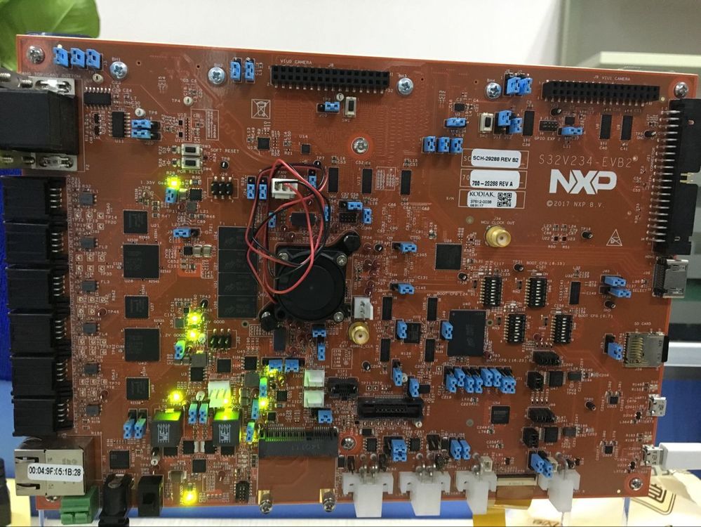

After set the ipaddr 192.168.5.xx,and then ping 192.168.5.1, failed!
log :

On uboot of bsp14.0 has the same issue. refer to :
ping fail on s32v234evb 29288 board
I use uboot  of bsp16.0, but I also can not ping  successfully now!
I want to to eth with ksz9031xxx, need I change jumper on sch-29288 rev b2?
I  check the user manual of bsp16.0, No jumper need to be adjust.
So what problem is it? Is my evb board  broken?
Thanks!

Hello again Echo,
Quick question: Is the entire route from the board to the other endpoint running at 1GBPS? Because by default, an s32v234evb running the bsp16.0 u-boot only supports Ethernet connections at 1GBPS. If you really need to connect at 100/10 MBPS, we can provide you with a patch that would allow you to do that.
2,058件の閲覧回数
echozeng
Hi,Dan Nica,
    Please push 100/10 MBPS patch (support uboot and linux  kernel) here,thanks!
