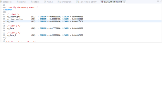

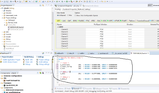

When i modify the Linker Files S32k144_64_flash.ld as follow:
I download the .elf file to the mcu ,but it cant run ,see picture
After that ,i modify the linker files as before see picture:
And save the file ,then down load the .elf file to the mcu ,and it also cant run.
See pircture
I just want to make a project work as app relative to bootloader.

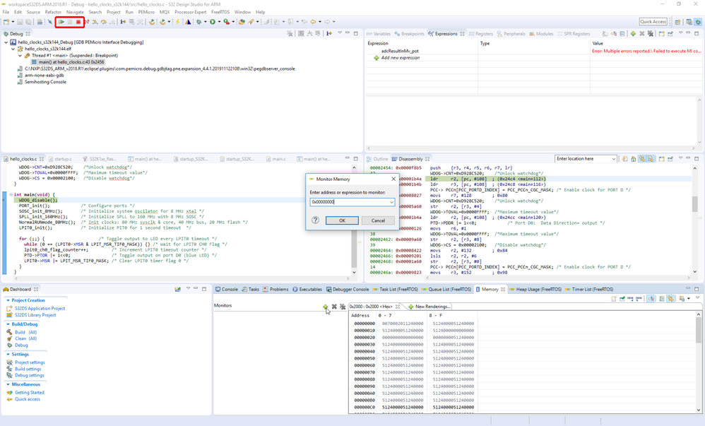

I can't read which address you used, but for boot you need boot data and vector table starting from 0x00000000. Flash config needs to be placed to address 0x400.
Jiri

jiri_kral
try to check memory if code is back on address 0x00000000. If you stop running - can you see where program ends?

jiri_kral
From your tiny screenshot it doesn't look that debugger is disconnected. Just click on Pause button. From disassembly you can identify on which address program ends. Memory you can view in memory tab when MCU is suspended:

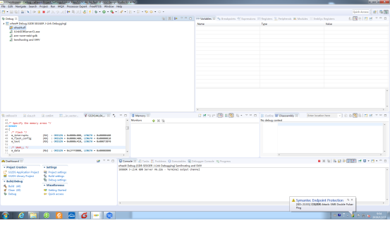

yongwan
it ends at 0x000000000
and a log"no source available for 0x0"disappeared

jiri_kral
What about memory content on that address? It is empty (FF FF FF FF ) or is there valid code?

yongwan
it is 00000000
6,810件の閲覧回数
jiri_kral
Okay, So, there is no valid code on address 0x00000000. Can you please share your project or s-record from your project?

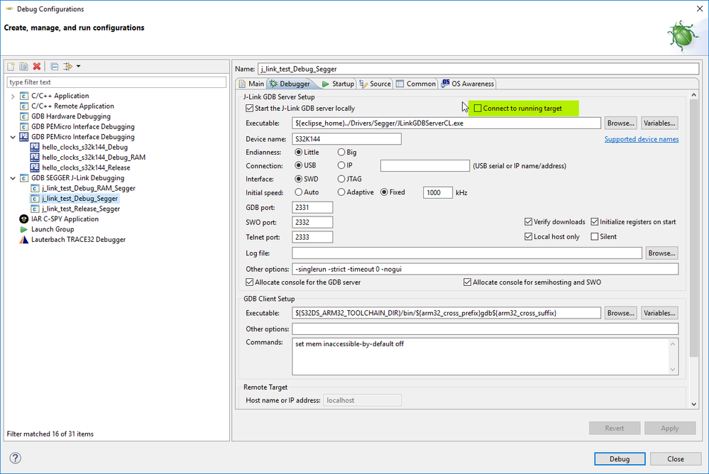

Looks okay. There must be some issue with your j-link? debugger settings. Please check debug session settings and share output from debug console:
