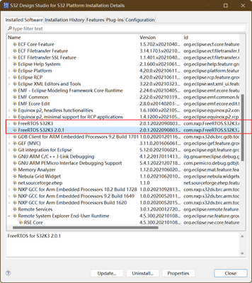

I want to burn a FreeRTOS in my s32k344, but there is no FreeRTOS in my component, why?

FreeRTOS is not included on S32DS. You need to download and install it.
Take a look at this community post: Support for FreeRTOS - S32K3

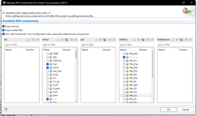

But after I downloaded the FreeRTOS package and imported it to S32DS, why is FreeRTOS still not found in s32DS?
