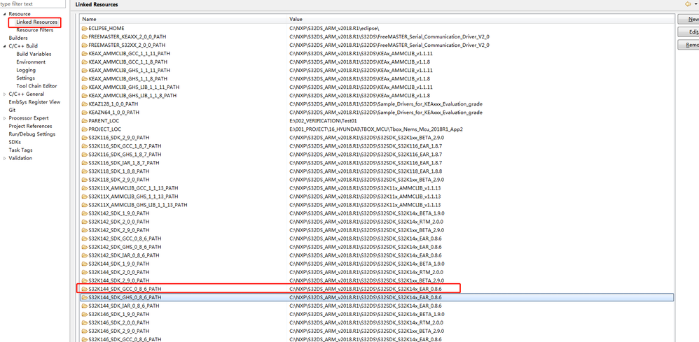

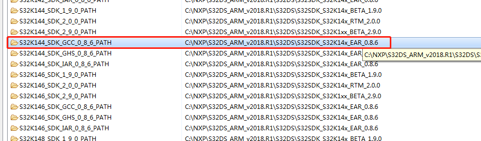

cheney
Hi, Stan:
Thank you for you reply.
It works when i change your the eclipse option as below:
-Ea S32K144_SDK_GCC_0.8.6_PATH="C:\NXP\S32DS_ARM_v2018.R1\S32DS\S32SDK_S32K14x_EAR_0.8.6"
Now what's keeping me from getting confused is the PATH variable definition.
The SDK path variable what i can see in S32DS is "S32K144_SDK_GCC_0_8_6_PATH". See the picture below:
Figure 1: Linked Resources
But in the project setting, the SDK path variable used is "S32K144_SDK_GCC_0.8.6_PATH".
Figure 2: Project setting
You can see that the '_' is replaced with '.'. Could you tell me the rules of the substitution and why the rules do not work in Eclipse's headless mode.?
And thank you for your reminding me using the new SDK. Our new project is constructed in RTM version of SDK.
Sincere appreciation.
Cheney
