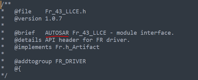

I am trying to use Flexray on the S32G3.
I see that LLCE 1.0.7 drivers contain both Flexray_43_LLCE_Ip.h and Fr_43_LLCE.h. They both seem to include/implement similar functions. Flexray_43_LLCE_Ip.h seems to match more closely to what is in the S32G3 reference manual (S32G3RM).
The FlexRay examples use the Fr_43_LLCE.h functions.

In general, the "_Ip" denotes that the file is not AUTOSAR compliant. Reviewing the content of both files, we see that the one that does not have the "_Ip" word on it shows the following note under the header:
While the one that has the "_Ip" does not show it.
