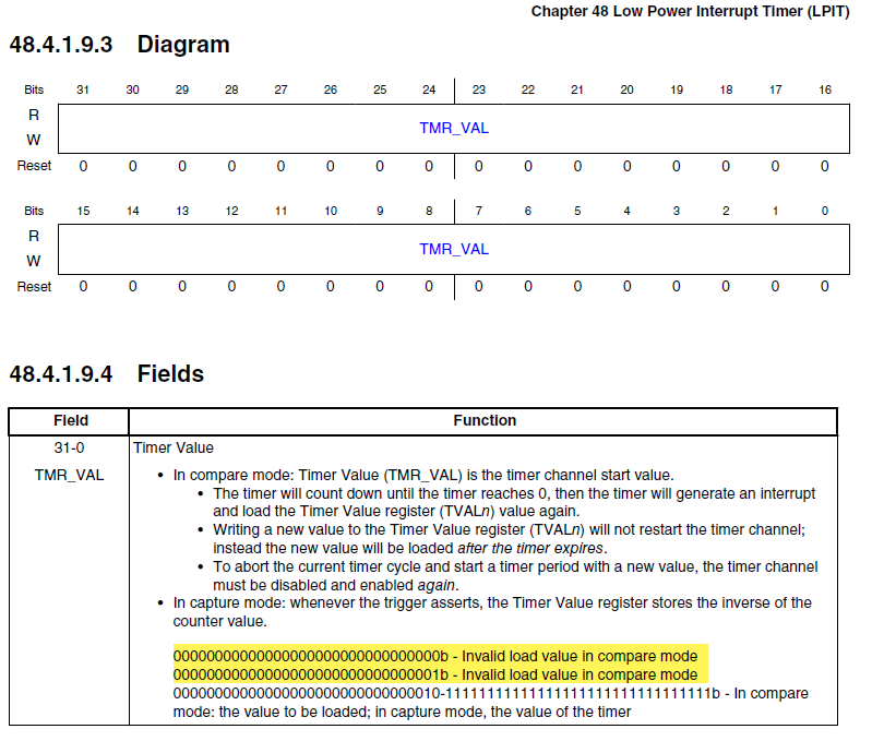

hello everyone!
I use the compare mode of lpit0  and accidentally set tval0 to 0 in the program. I find that cval0 starts count from 0xFFFF_FFFF. Why?

Hi 永锋 季,
00000000000000000000000000000000b - Invalid load value in compare mode
00000000000000000000000000000001b - Invalid load value in compare mode

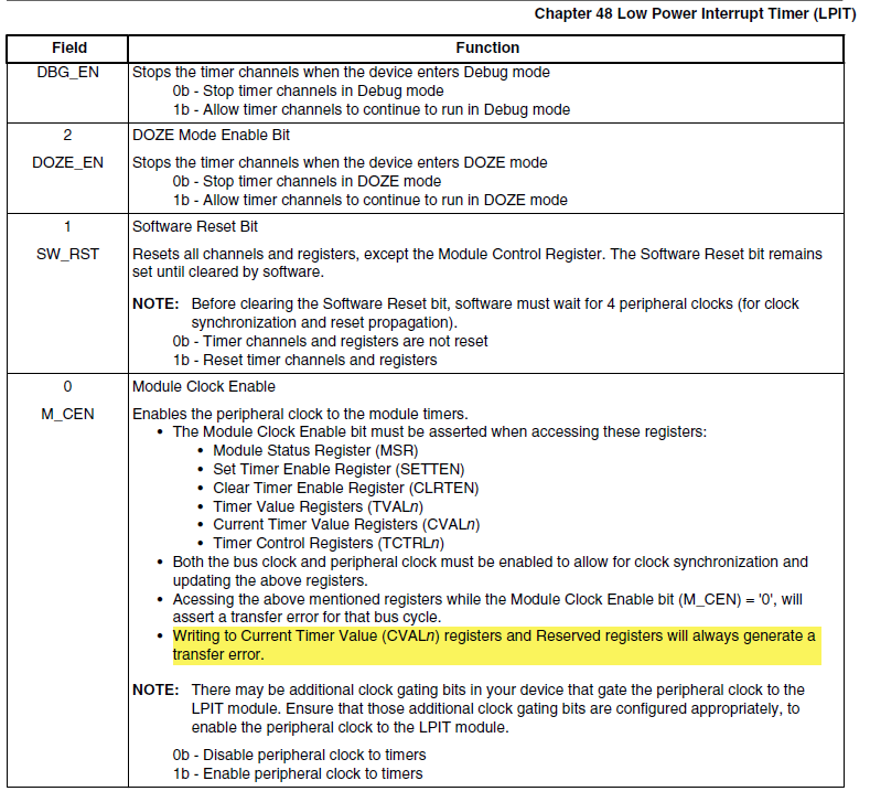

The Access of Current Timer Value CVAL is RO(read only). I don't know why you write 0 to it.
I am not sure if it was caused by below:
Robin

Hi Robin_Shen,
Sorry, I want to say tval0. So my question is:

ym1
Thank you,Robin_Shen. I got it.
