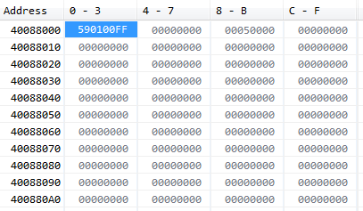

I am trying to get an Irq from watch dog timeout but unable to do so. Could be please point out my error.
Below is the code snippet.
void watchdogtest()
  /*Enable watch-dog*/
    enable_irq (INT_SWT_0 - MAC57D54H_FIRST_USER_IRQ);
    route_interrupt (INT_SWT_0 - MAC57D54H_FIRST_USER_IRQ, 0x03);
  SWT_0.SR.R = 0x0000c520;
  SWT_0.SR.R = 0x0000d928;
  SWT_0.CR.B.WEN = 0;
  SWT_0.TO.R = 0x500;
  SWT_0.CR.B.ITR = 1;
  SWT_0.CR.B.FRZ = 0;
  SWT_0.CR.B.WEN = 1;
  SWT_0.CR.B.SLK = 1;
  uPrintf("In a While Loop...\n");
  while(1); //
vector 122 is corresponds to SWT0
#define    VECTOR_122      default_isr_test  /*default_isr_test is dummy function to test an IRQ*/
clock SIRC is enabled .
and below is the register value corresponding to SWT0
Thanks in advance,
-Prashant

BTW, if you are talking about enabling SIRC clk then we have already have below code at start up which is used to enable the SIRC.
    /* Turn on FXOSC, SIRC and SXOSC - can integrate this into enable PLL step - leaving separate for now during testing */
    MC_ME.DRUN_MC.R = 0x00130030;
    MC_ME.MCTL.R    = 0x30005AF0;
    MC_ME.MCTL.R    = 0x3000A50F;
let me know if it is different ..
