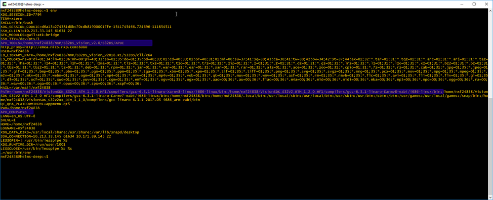

Hello Sir,
we build below, and fail following, could you help us build success?
Michael wu
VisionSDK_S32V2_RTM_1_2_0_HF1/s32v234_sdk/demos/isp/isp_ov10640_default/build-v234ce-gnu-linux-d$ make clean;make allsub
./kmem.c:2:21: warning: backslash-newline at end of file
 char kmem_srec[] = {\
./kmem.c:3:1: warning: missing terminating " character
./kmem.c:3:1: error: missing terminating " character
../../../../../isp/graphs/ov10640_default/src/ov10640_default.c:40:1: error: expected expression before ‘static’
 static SEQ_FdmaCfg_t FastDMA;
../../../../../build/nbuild/helpers.mk:156: recipe for target 'ov10640_default-c.o' failed
make[2]: *** [ov10640_default-c.o] Error 1
make[2]: Leaving directory '/home/michaelwu/VisionSDK_S32V2_RTM_1_2_0_HF1/s32v234_sdk/isp/graphs/ov10640_default/static_ov10640_default/build-v234ce-gnu-linux-d'
../../../../../build/nbuild/sub.mk:73: recipe for target 'allsub' failed
make[1]: *** [allsub] Terminated
make[1]: Leaving directory '/home/michaelwu/VisionSDK_S32V2_RTM_1_2_0_HF1/s32v234_sdk/isp/graphs/ov10640_default/static_ov10640_default/build-v234ce-gnu-linux-d'
make: *** [allsub] Terminated

2,225 Views
michael_wu
Hello Jiri,
We have config the environment same as yours highlight, but still get the same compiler failed.
The picture is our setting. I am sure these paths are existed.
Michael Wu
2,225 Views
jiri_kral
I can built this demo without any issue (just by calling make allsub). My OS is ubuntu 16.04LTS. Do you have set correct path to compilers?
Jiri
