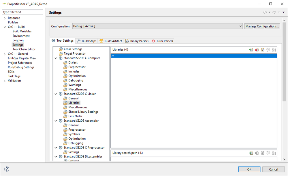

Do you want to use only EWL library? You can use newlib library instead:
1. Delete #define fabs(x) implementation from your Main_Z4b.c file
2. Add libm library in linker settings and delete "${VLE_EWL_DIR}\lib\e200z4\fp" from Library search path
3. Select newlib in Target Processor settings
I hope it will help. :smileyhappy:

i tried hello world project - and only what I need to add is #include <math.h>
Also make sure that hardware floating point is enabled in project properties:

jiajian_qiu
Hi Dmitry:
   I use new library and 'fabs()' work now ^_^.
   Thanks very much.
