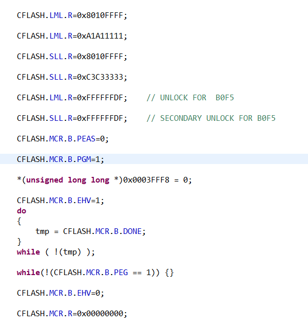

I'm trying to flash 8 bytes of data at a particular address.
I built the project, with release, and used to debug with the same release configuration, I can able to see the flash data, as I'm reading data from the same address and sending data over CAN so as to ensure for the successful flash. I can see the same in debug window too.
Now, if I try to flash the same compiled code from the bootloader, it is not able to flash the data as I can see the same old data. Everything else is working as expected. I can't see debug logic now as it is flashed from the bootloader.
I ensured the disabling interrupts using __asm("wrteei  0") ; command and the erase logic is as below.
Also, One thing I want to mention if I flash the debug code(110KB) (build with debug), which is having more size compared to the release version(77KB), I can able to see things working properly i,e, I can able to see the flash data as expected using CAN messages.
Kindly help in this regard.

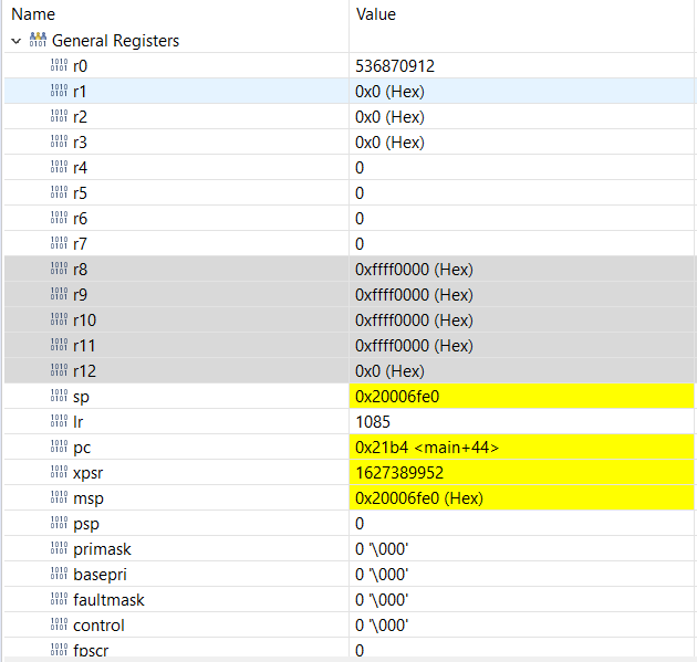

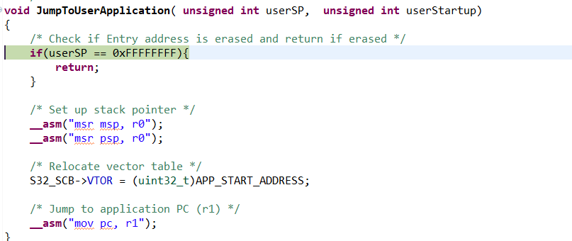

bjrajendra
Senior Contributor I
Hi Jiri,
With Optimization none-O0, I noticed that the register r1 is automatically loaded with the pc address once I call JumpToUserApplication (); below is the screen shot of the same
where as with optimization-O3 I observed that the r1 is loaded with 0x0 which is starting address of isr of bootloader.
My JumpToUserApplication() is as shown below
Raju
5,285 Views
jiri_kral
I don't understand your jump to app code.  You need to store your APP_START_ADDRESS into r1 first, then move it in program counter. It is not good practice to rely on compiler that some values stored in registry will remain unchanged.
Prior calling mov pc,r1  use ldr r1, =APP_START_ADDRESS
It is possible - that with -O0  this address remains in r1 from previously executed code. That's exactly what I mean by - 99% optimization failures is caused by the way how code is written and higher optimization level just uncovers mistakes.
Jiri

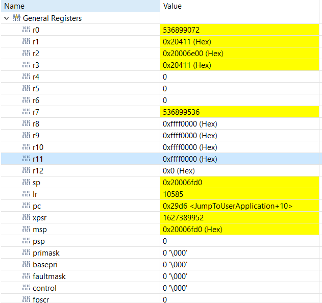

bjrajendra
Hi Jiri,
Thanks for your valuable suggestion.
I tried as per your suggestion. Below are the registers stored before mov pc,r1 command wheree the r1 is loaded with the address 0x20411 (so far so good)
After execution of the mov pc,r1 command, all the registers got reset and the pc is stored with 0x20450 which is WDOG_EWM_IRQHandler();and got stuck there. The screen shot is as shown below.

jiri_kral
in my opinion instead changing PC is better idea just jump to address (after you moved correct start app address in r1):
bx r1
or
b r1
Jiri
