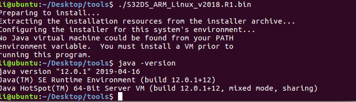

S32DS requires Java 8. Open JDK is ok ( apt-get install openjdk-8-jre ).

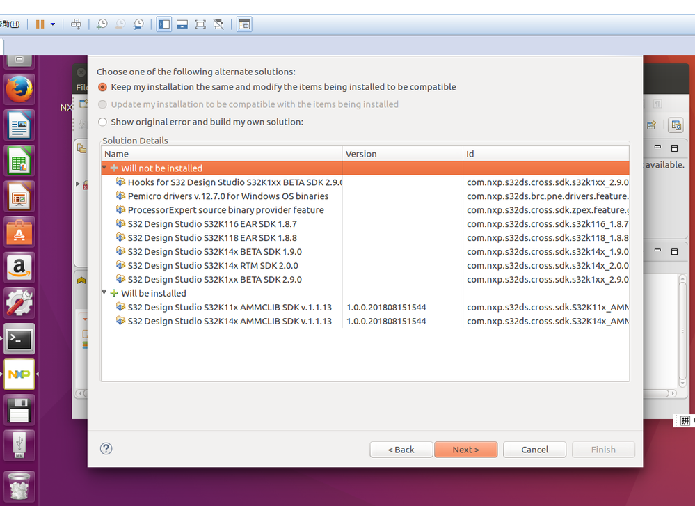

hello,
i install SDK is fail,
help->install new software->path:S32DS_ARM_v2018.R1_UP10.zip
but SDK no SDK 3.0
i need S32K148 SDK 3.0

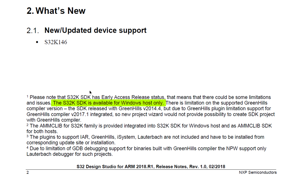

jiri_kral
unfortunately SDK is supported only by MS  Windows host system. Please see release notes:
Jiri

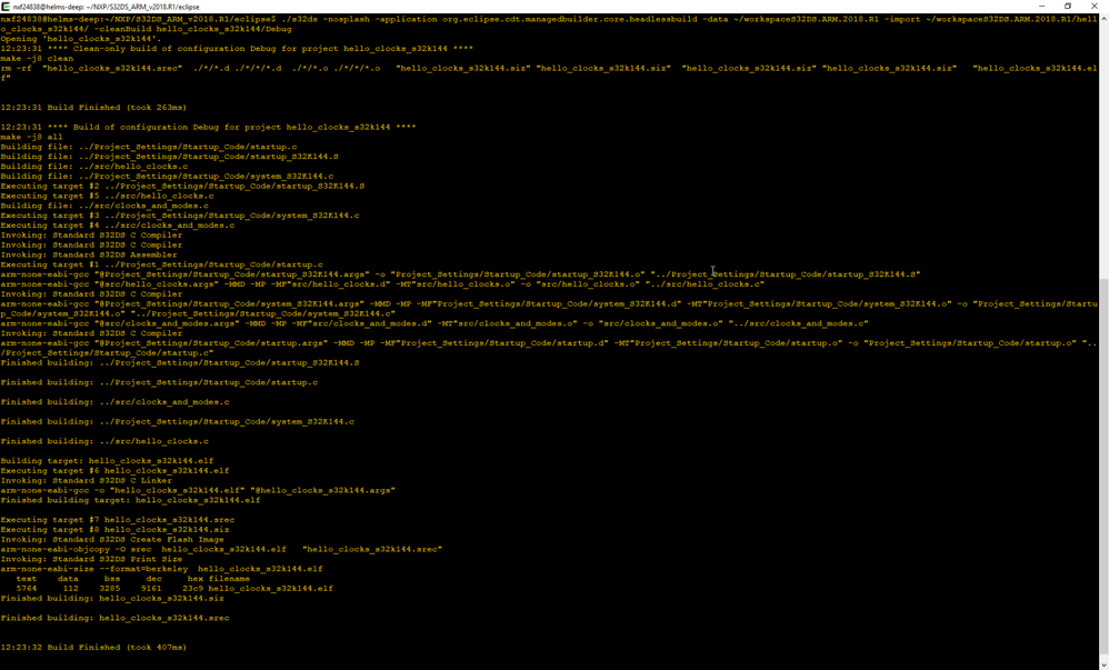

jiri_kral
Here is build command for hello_clocks_s32k144 example wiht  default install paths:
./s32ds -nosplash -application org.eclipse.cdt.managedbuilder.core.headlessbuild -data ~/workspaceS32DS.ARM.2018.R1 -import ~/workspaceS32DS.ARM.2018.R1/hello_clocks_s32k144/ -cleanBuild hello_clocks_s32k144/Debug
Be sure that you are launching this command from eclipse home - by default ~/NXP/S32DS_ARM_v2018.R1/eclipse
parameters are:
-application -> eclipse managed builder
-data -> path to your S32DS workspace
-import -> path to your project
-cleanBuild -> project name including configuration (Debug in this example)
Hope it helps.
Jiri

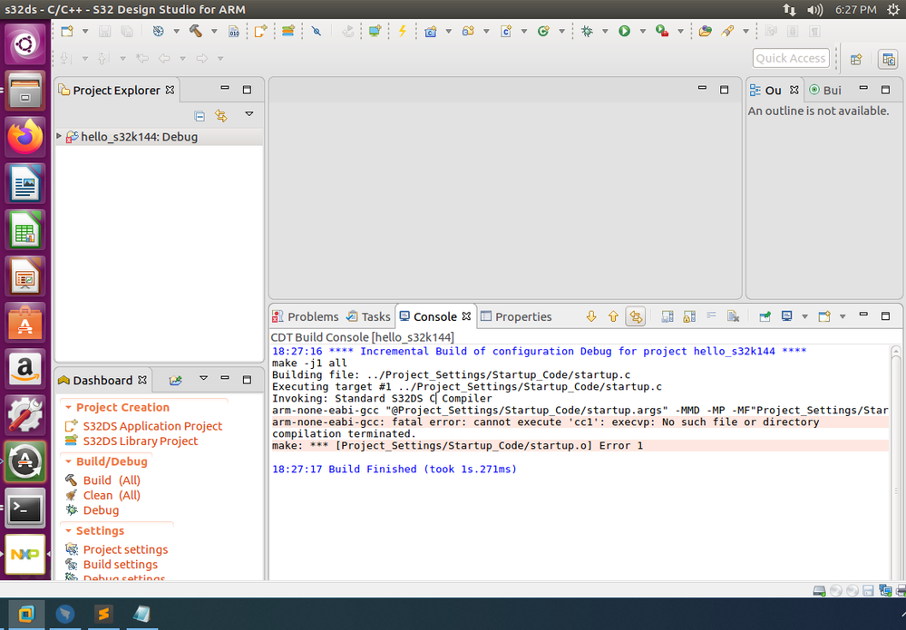

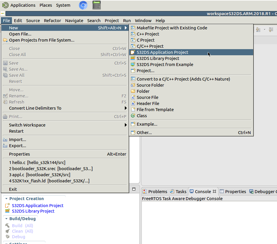

gravity_one
hello,
issue 1:
   use example,build error!in linux
   file->new->S32DS project for example->hell_s32k144
   press [build]
issue 2:
   i use example in windows,
   copy to linux,
   into project.debug
   make
  i need modify what?

jiri_kral
the cc1 is normally present in ~/NXP/S32DS_ARM_v2018.R1/Cross_Tools/gcc-arm-none-eabi-4_9/lib/gcc-none-eabi.4.9.3  directory. Can you check if cc1 executable is persent? If not, try to re-install S32DS.
The best way how to compile project from bash is using command mentioned above. It also generates makefile for project and calls correct compiler. By using just make in Debug folder - you need to specify path for arm-none-eabi-gcc in system environment.
To produce .bin output you can  use
arm-none-eabi-objcopy -O binary  your_project.elf   "your_project.bin"

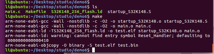

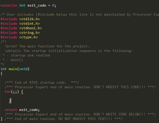

gravity_one
hi,
The coding is done, but put it on ubuntu,
i think modif bash,then make,generate .BIN,
how to modif  bash?
A simple test was done, failed, and the generated .BIN was bad.
Can you give me an example? Like this
main.c
Everything else is SDK 3.0 standard file
10,522 Views
jiri_kral
It looks, that you build and link only main.c and startup_S32K148.S sources. The simpliest empty application also should contain startup.c and system_S32K148.c sources.
Anyway, what's your goal?
Jiri
10,522 Views

gravity_one
Using generated makefile from project, I try to modify makefile , but it fail.
Can you tell me how to modify about makefile from project?
1、add include "s32_core_cm4.h" on startup.c, but error
2、warning: cannot find entry symbol Reset_Handler; how to modify?

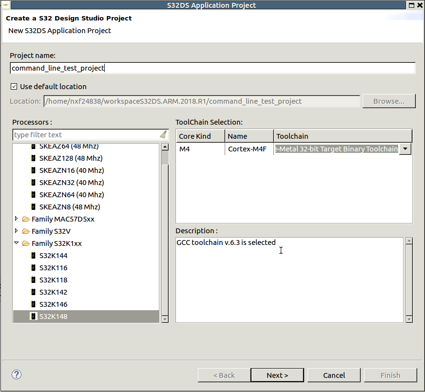

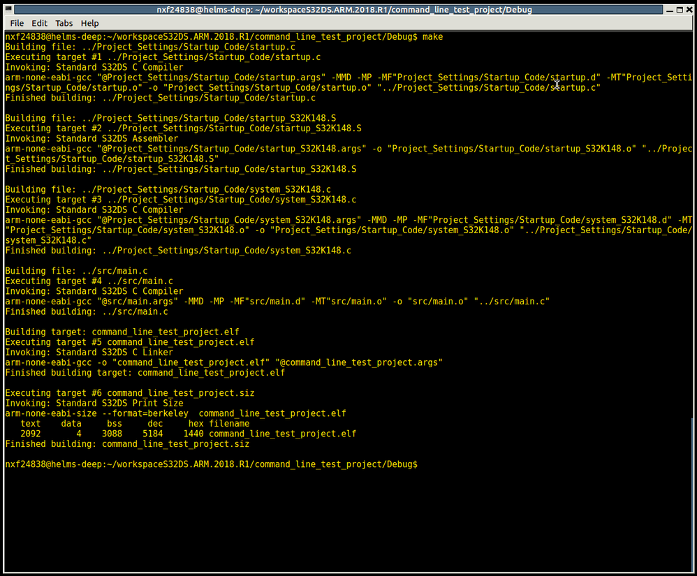

jiri_kral

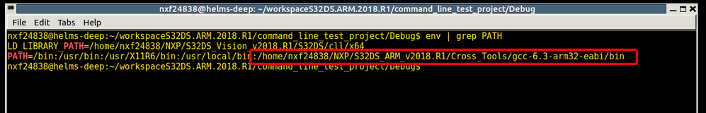

The easiest way - in my opinion - if you for some reason don't like call s32ds in command line mode for building your project (https://community.nxp.com/thread/519285#comment-1241074) is create project in GUI for your target device and build it for first time (this also generates makefile with correct include paths):
Then you can close S32DS and build project from command line:
The supported gcc version is 6.3 - part of S32DS Installation. Easiest way is just add path to PATH env variable:
Jiri

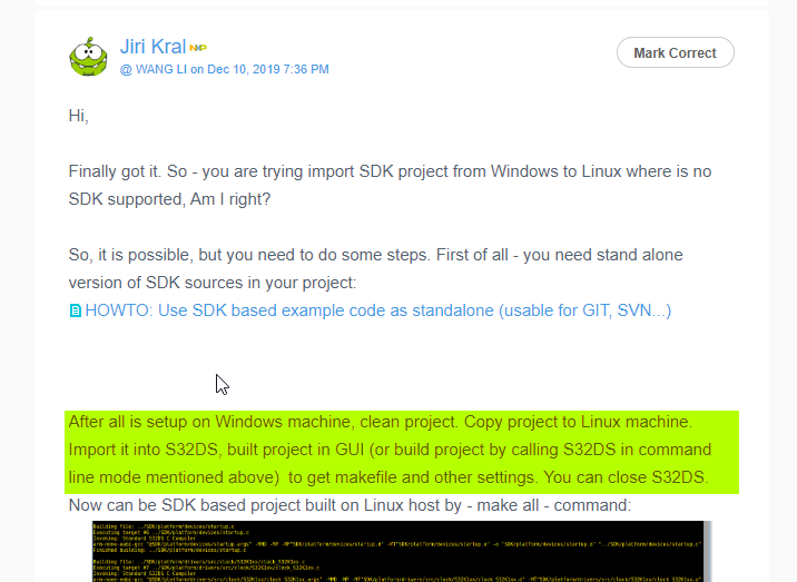

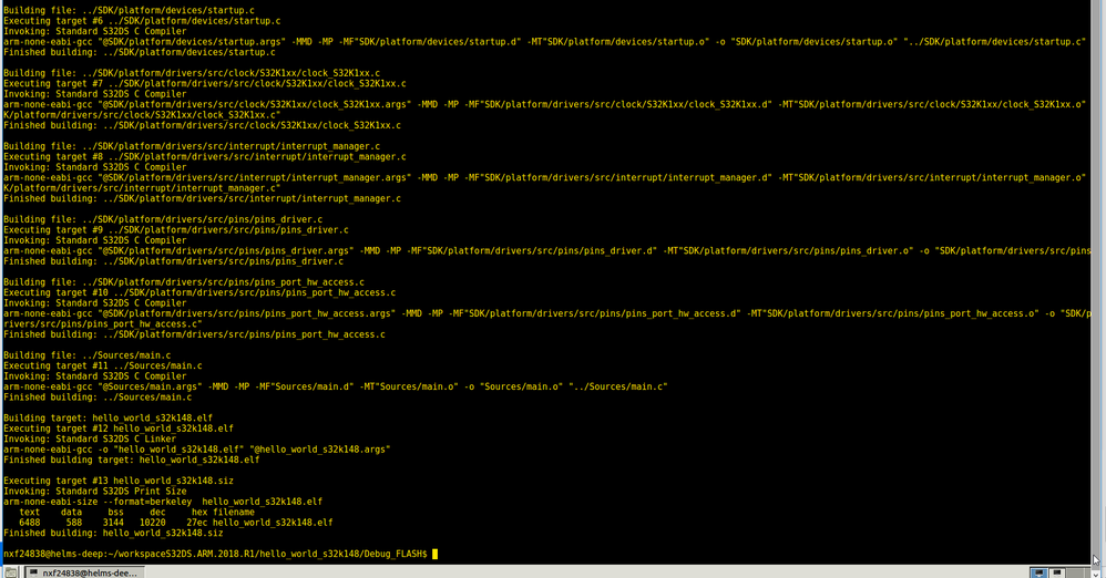

jiri_kral
Finally got it. So - you are trying import SDK project from Windows to Linux where is no SDK supported, Am I right?
So, it is possible, but you need to do some steps. First of all - you need stand alone version of SDK sources in your project:
HOWTO: Use SDK based example code as standalone (usable for GIT, SVN...)
After all is setup on Windows machine, clean project. Copy project to Linux machine. Import it into S32DS, built project in GUI (or build project by calling S32DS in command line mode mentioned above)  to get makefile and other settings. You can close S32DS. Now can be SDK based project built on Linux host by - make all - command:
Hope it helps.
Jiri

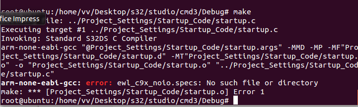

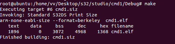

gravity_one
hi,
i use other install  S32DS on linux, new project, into DEBUG ,"make" is sucessful .
but ,copy project form windows to linux,into DEBUG ,"make" is error.
11,275 Views
jiri_kral
did you clean yout cmd3 project in windows machine, then import it in GUI, built it for first time in GUI? Makefile generated on windows machine doesn't work on Linux host
Jiri
