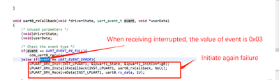

Hi NXP engineer, sometimes the UART receiving interrupted and the value of event is 0x03 in rxCallback function. What is the reason?   And I tried to initiate UART again, but failled

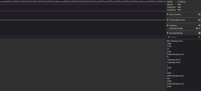

In S32K144W MCAL UART example, i am getting framing error in UART_SEND, when checking with logic analyser.

Hi @Hanchun,
The callback with UART_EVENT_ERROR is called from
lpuart_driver.c
LPUART_DRV_ErrIrqHandler()
Possible reasons: LPUART_RX_OVERRUN, LPUART_FRAME_ERR, LPUART_PARITY_ERR, LPUART_NOISE_DETECT
Can you place breakpoints at the lines where the callback is called?
Thank you,
BR, Daniel

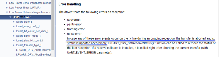

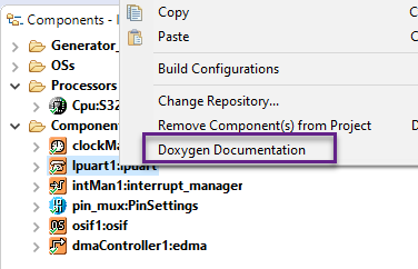

Regarding the driver, please refer to the SDK documentation.
Righ-click on the LPAURT component:
There is no need to reinitialize the driver.
You can call another transfer function.
BR, Daniel
