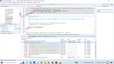

Hello everyone, I have a problem and need help:
I lost Location and Path of error when building project. How to turn on it?
I'll appreciate any help.
Cheers,

you are probably mixing two Autosar versions as is written in the first #error message. It is possible share your project?

 This is my "Problem view". when i double click on the error, I can't go to the error line. However, on the S32DS of my friend, the double will bring to the line of the error.

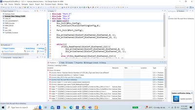

can you please share the output from build console?
1,690 Views
tuanhoc8
@jiri_kral
This is the "Problem view" of my friend.
After build the path and location of error  appear and he just click on it, the line of the error is selected. However, my S32DS doesn't have the path and location of error after build.
