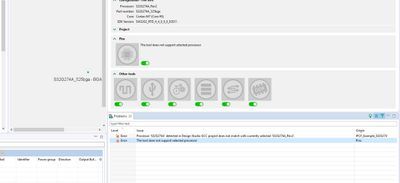

Hello Team,
Customer facing below errors in S32 DS 3.3, pls advice:
    • Error: Processor 'S32G274A' detected in Design Studio GCC project does not match with currently selected `S32G274A_Rev2`.
    • Level: Error
    • Type: Tool problem
    • Tool: McuConfiguration
    • Origin: IPCF_Example_S32G274
    • Resource: Processor
    • Information: -
  • If they switch to S32G274A, then there are attached build errors
Please find more details.
Design Studio : Version: 3.3,Build id: 200610
RTD Version : SW32G2_RTD_4.4_0.9.0
IPCF Sample program (S32 IPCF 1.1.0 D2012
Documents Referred: IPCF Shared Memory Driver User Manual Version 1.4
They are observing issues in S32 Design Studio. They are unable to select appropriate hardware to configure.
Once the IPCF example project is imported in DS, there is a mismatch BGA observed.
Even if they choose S32G2745A_525bga the tool does not support selected processor.
Please let me know if you need any other details to be checked with them

Hello @_manoj_kumar ,
It's possible some package or update is not installed. Could you please go to S32DS Extensions and Updates menu and click on 'Installation Details' link at upper right. Then send the details of the installed packages.
Mike

_manoj_kumar
I have attached the error snapshots. Please let me know if you need any other details.
