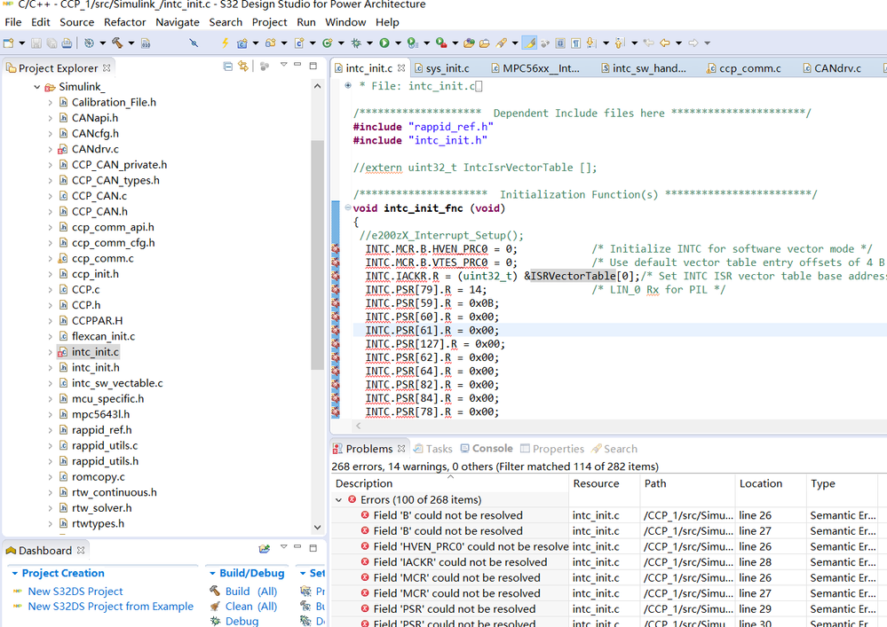

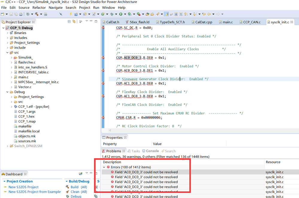

Hi Guys,
From the time that i use the S32 complier,there are some error in my project,but when i complier my project,there some error souch  as "Description Resource Path Location Type Field 'PSR' could not be resolved intc_init.c /CCP_1/ src/ Simulink_ line 29  Semantic Error",shown as below:

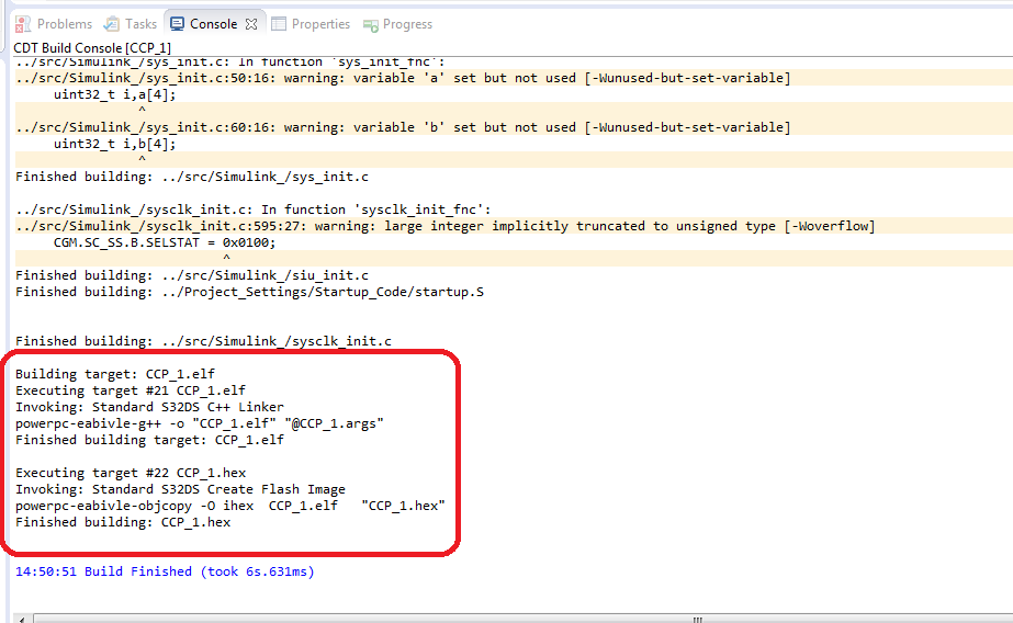

but it can generate the *.elf or hex file.when download the c-code,chip run normally,  but i feel the error in my project is not so good,Who can help me?
the attachment is my project!

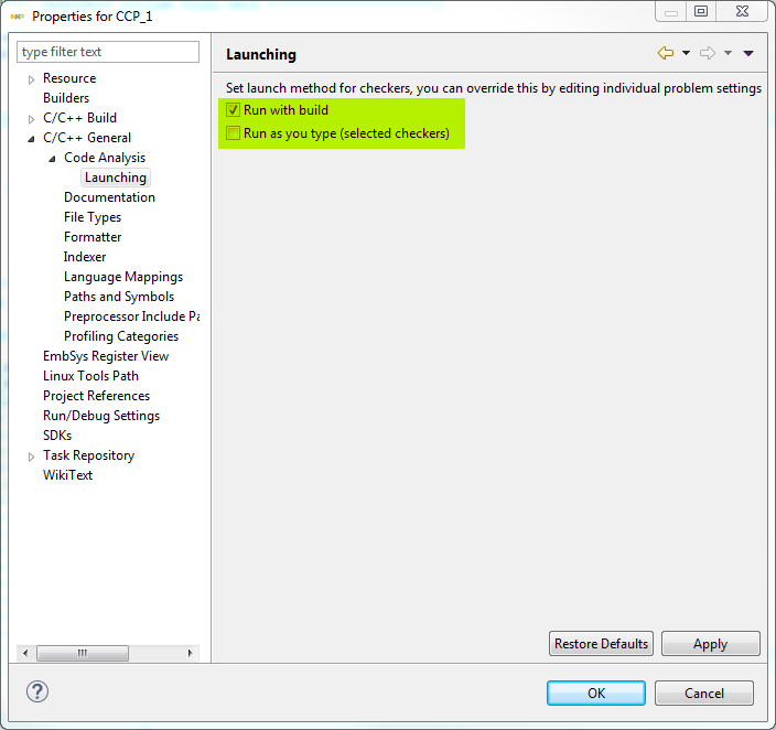

I'm able reproduce your issue - and here is workaround:
Right click on project name -> Properties -> Indexer  and enable Project specific settings and Use active build configuration.
Then select Code Analysis -> Launching and select Run with build and deselect Run as you type
As a last step Close and open your project again. Hope it helps.

As your advise,I operate but the Error still popup,shown as below:

Thank you for your report. This is a known issue related to CDT.
This should be fixed in the next version of eclipse (Neon) in S32DS for Power v2.0
The planned release date is Oct/Nov 2017.
The workaround is to simply ignore the Problems View in case .elf file is generated and rely more on Build Console output instead.
