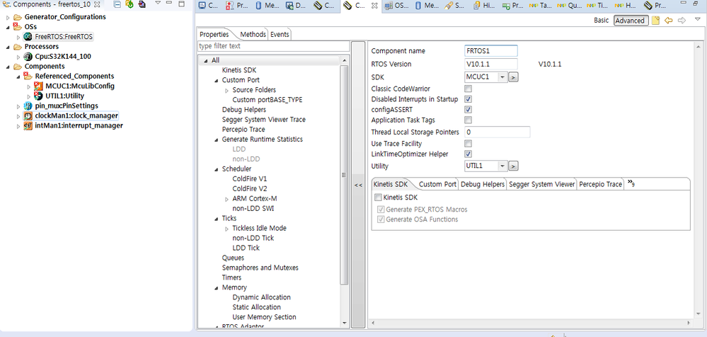

I want to use FreeRTOS 10.1.1 on S32DS.
So I imported Components from McuOnEclipse.(201809-30)
1. make new project
2. add FreeRTOS.
3. Generate Processor Expert Code.
4. There are problem.
696 Views
BlackNight
Did you follow the tutorial on Tutorial: FreeRTOS 10.0.1 with NXP S32 Design Studio 2018.R1 | MCU on Eclipse ? It seems you have missed the step to copy the extra files for Drivers/common?
I hope this helps,
Erich
696 Views
yumjeongwon
Thanks. I will double check it.
I'm in Error during not build but Processor Expert Code Generating.
