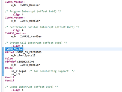

IVOR8 is System Call Interrupt which is triggered only by software by executing se_sc instruction. It's used by FreeRTOS. You can find in source files of that project:
If you port the code to another core, this IVOR8 needs to be initialized as well.

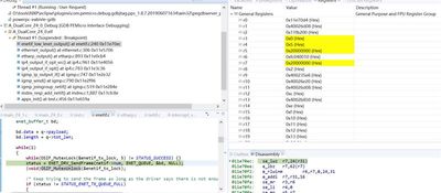

   When it runs to send arp packet in function enetif_low_level_output(), now it is OK,

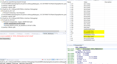

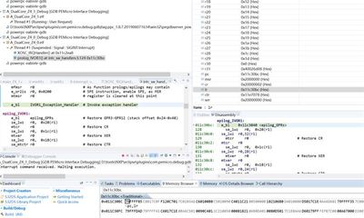

next step to the line of OSIF_MutexUnlock(),  the process run away, then I suspend , it appears different interrupts(there are some null IRQhandle in the example project, maybe they are not used except ENET, but it run success in core 1, then I del the null IRQhandle in the section intc_vector_talbe, it go to the next null IRQhandle, at last I del all the null IRQhandle , it appears IVOR8_IRQhandle)
in the section_vector_table, some interrupts handle in the lwip_example_project are not realized,
