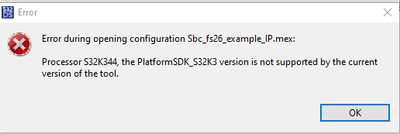

We have a project where we use a combination of S32k342 and the SBC FS2600.

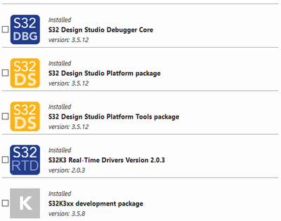

S32DS Version: 3.5 Build id: 240529 (Update 12) and the RTD 2.0.3
After installing the FS26 SW version 4.0.0 CD 01
i get this error when i try to open the example project [Sbc_fs26_example_IP_S32K344]
Any idea how to resolve this problem ?
Thanks in advance !

Hi @Kazarian
This software version requires the S32K3_S32M27x Real-Time Drivers AUTOSAR R21-11 Version 4.0.0. You can download this RTD version from S32K3 Standard Software > Automotive SW - S32K3/S32M27x - Real-Time Drivers for Cortex-M.
BR, VaneB
