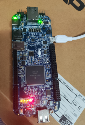

Error in services launch sequence The GDB Server was not able to establish a connection to the target processor. Please check your connections and power. Verify that the launch settings in the Debug Configuration are accurate. To run simultaneous debug sessions, please specify a unique Server Port and GDBMI Port.

power supply and probe connection is okay (there are two micro USB connectors)? Do you have chance test it with different board?

There is only one micro USB connector for each board. I don't know if this is normal for power supply and probe. And I have two MPC5748 boards. I have tested them, and the results will show that error. Is it the problem of GBD setting?
